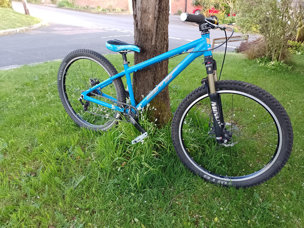

Posts: 6235
Just been building up the bike for my daughter...pics to follow at some point.
Frame off eBay arrived today. Very tidy 14" DMR Trailstar. Disc only, so probably circa 2010/11.
I have a soft spot for DMRs, I have a couple and the wife has one, so keeping it in the family.
Having some fun putting slightly retro, but totally OTT parts on a kids bike 😁
Hope headset and stem; tubeless Mavic wheelset; Salsa Moto Ace bars; Paul Components chain tensioner; Manitou Minute 100mm fork.
She truly is my daughter...we were discussing the bike earlier, and she insisted it be a single-speed, "just like yours". 😎

Posts: 6235
14" DMR Trailstar (MK3? It's disc only)
Single-speed - but with a Paul's tensioner and a 2nd sprocket on the back, so it can be changed with a bit of faff.
The head angle isn't as steep as it looks in the photo, but it's not modern slack geometry.
First ride today and she loved it 😎
