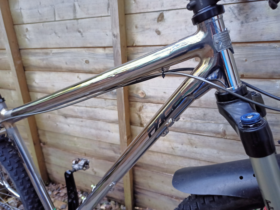

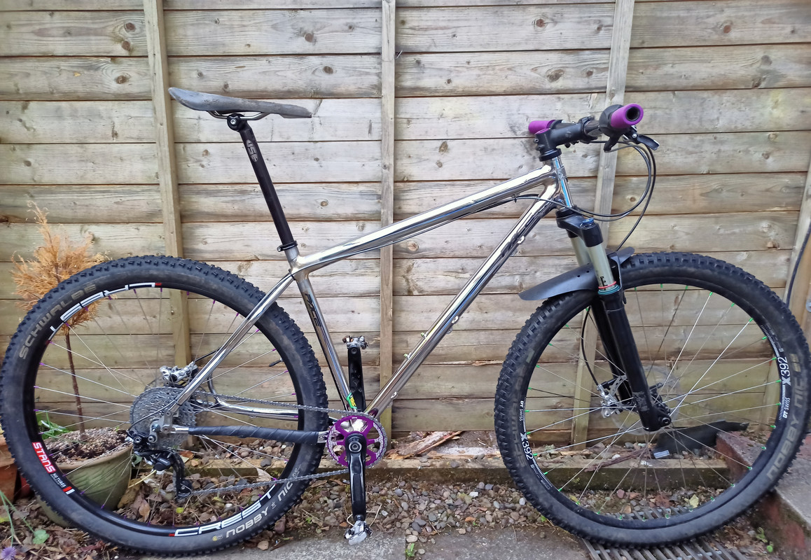

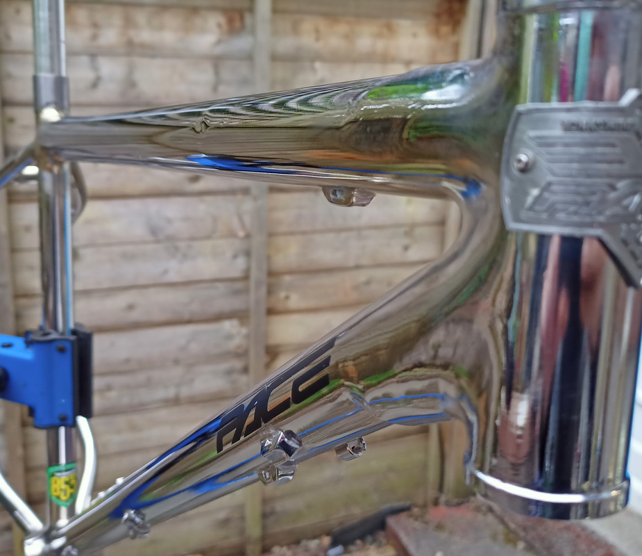

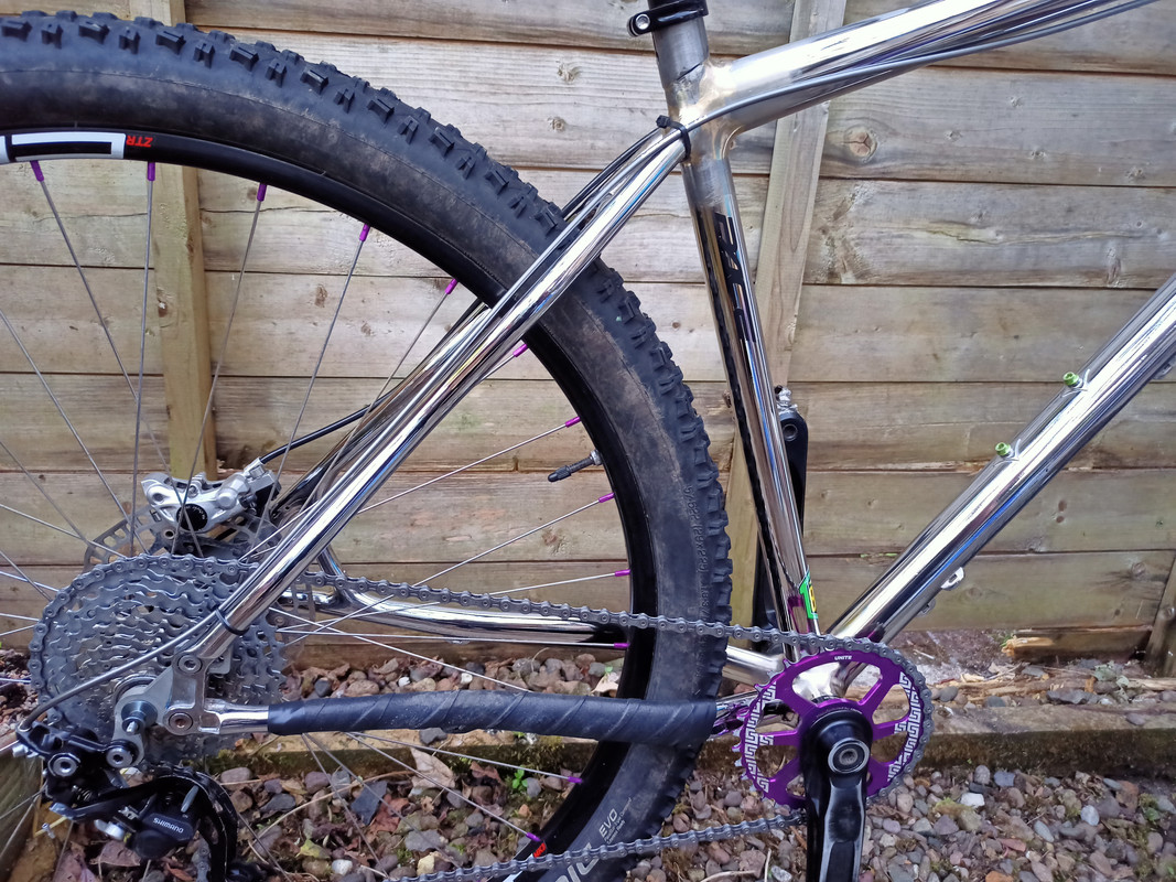

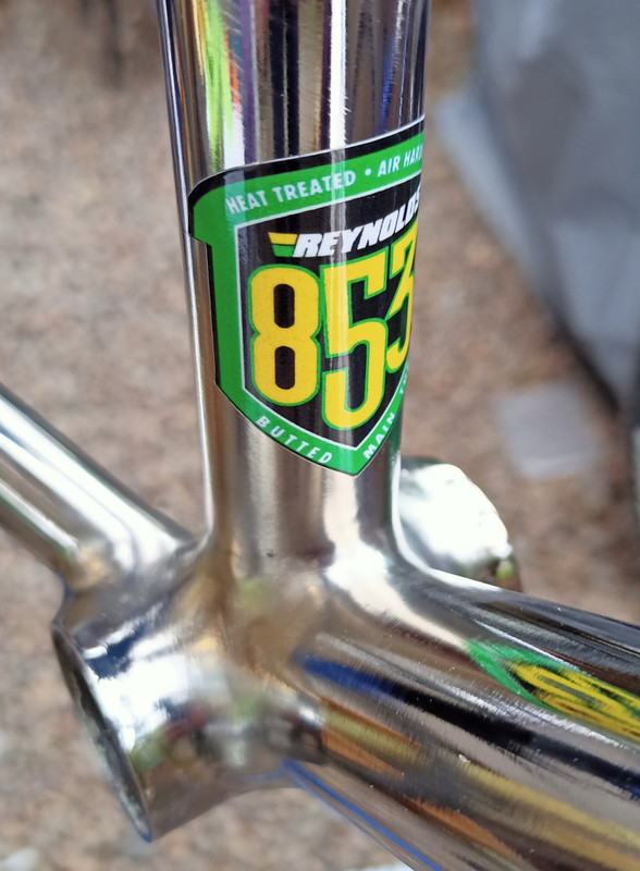

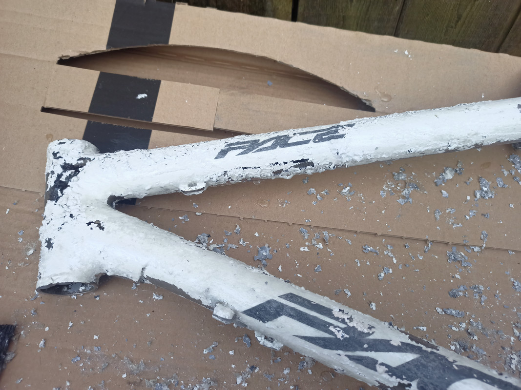

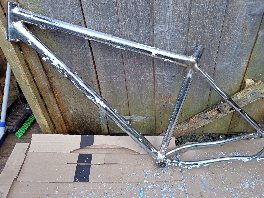

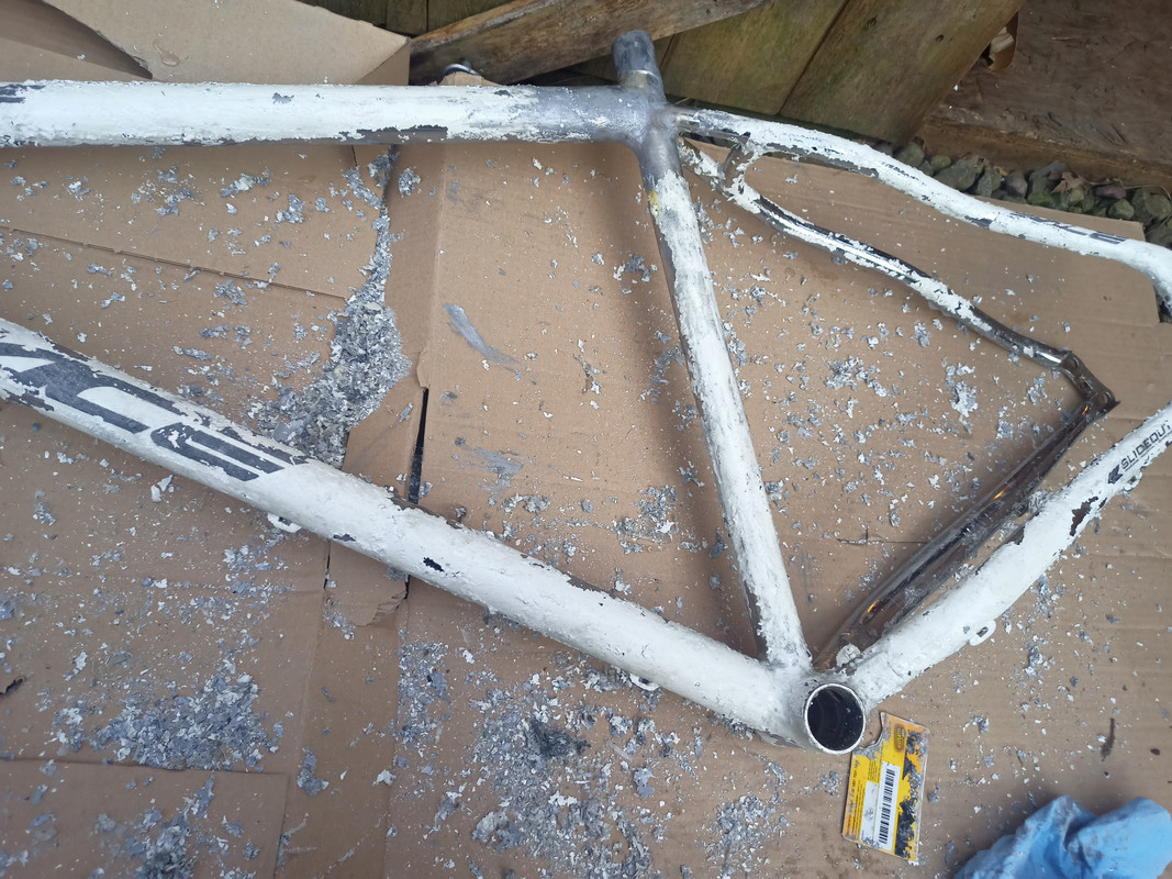

Thread update.
Decided to go for stripping it anyway, knowing it'll not be perfect, and that it telling a story would be nicer than just getting it coated from the off.
How it started:
original Pace
stripping the paint
stripping paint1
stripping paint 2
coming off OK?
mostly done
polish and decals
polished 1
polished 2
first build back up!
build 1
build 2
build 3
build 4
I think it turned out OK.
got some cable guides on order so I can route the cables properly, and some end plugs...
Posted : 22/06/2021 10:19 am

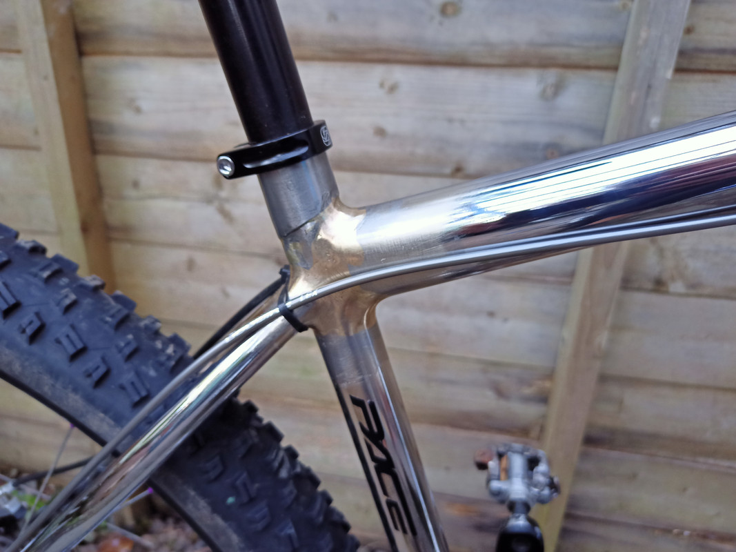

Posts: 10225
Is the seat tube repair not fully welded all the way around - just tacked on? Looks like a line / gap where it joins the frame?
Posted : 22/06/2021 11:18 am
Posts: 3300
Is the seat tube repair not fully welded all the way around – just tacked on
think that's just the photo. It's a collar brazed all the way round, the original squinty front facing slot has been filled and replaced by rearward facing slot too.
Posted : 22/06/2021 11:34 am

Posts: 3300
cheers.
in all honesty, it only really took about a day to sort. I got sidelined so many times by garden jobs/going to the beach/going into the mountains on dry days that it took a good couple of months to get to this stage!
The most difficult bit was cleaning up the repair as it'd been sat in the shed for ages it started to corrode. that part has been lacquered, the rest of the frame went orange peely, so i left it. It will corrode and degrade over time and I'm sure that I'll do something different when that happens, but for now, I'll be enjoying the shininess.
actually, the most difficult bit was lining up the slackset properly...
Posted : 24/06/2021 9:39 am

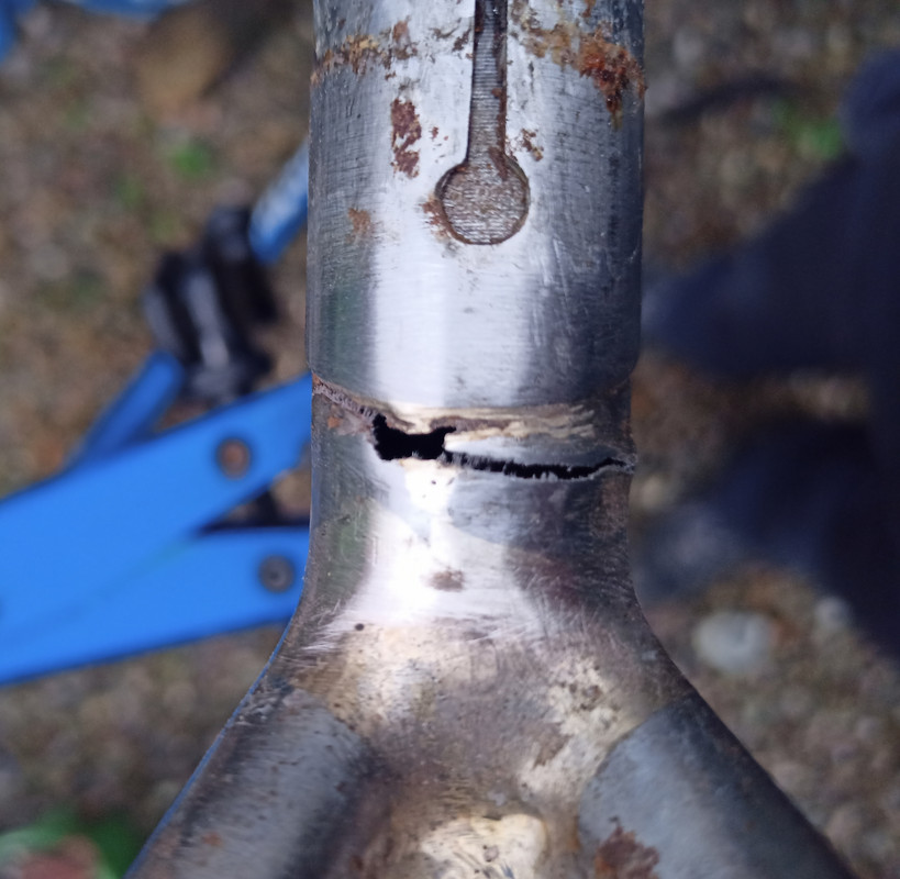

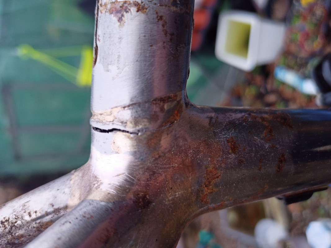

This happened a while ago...
crack1
crack2
After it being sat in the shed for an age, it's getting filled and brazed to see if that works as a repair.
I was thinking, as the original seat tube was wafer thin, if I get a longish 4-5" seatpost shim and epoxy it to the inside of the seat tube, will it add much in the way of reinforcement?
It's 27.2, so thinking of a 27.2 down to 25.4 to give it a bit of meat.
Assuming I think the frame is worth the effort, would a permanent shim help?
Ta
