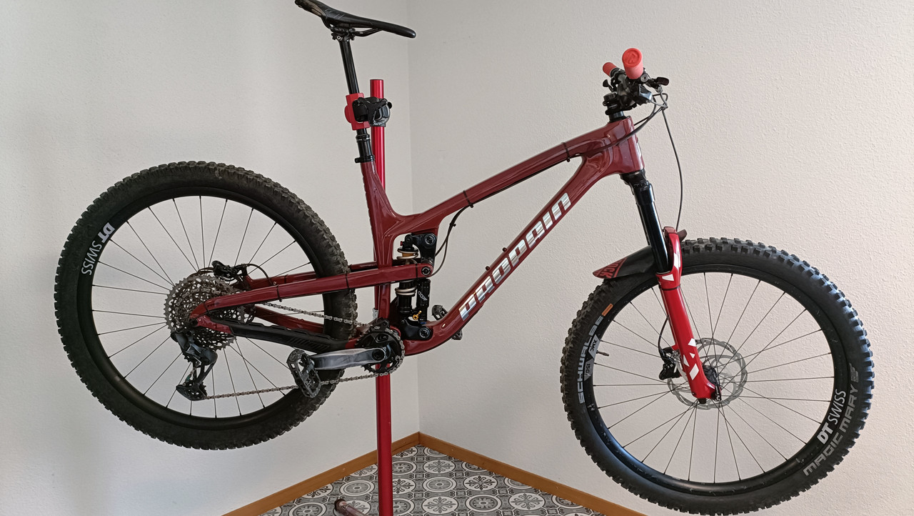

Propain had a sale offer before Christmas that I found irresistible. 25% off frame and shock, and all other parts moved across from my old bike. The forks were switched from 150mm to 170mm travel.
A Propain is not such a common sight in UK, but they are popular and well regarded in Germany and Switzerland. It is one of the most common bikes on the shuttle trailers in Finale Ligure for example.
The order experience wasn’t exactly great. I ordered it with an advertised 4-6 week delivery time. After 6 weeks I sent an email to only then be told it would be another 4-6 weeks. It took a second email to confirm the shipping. The actual delivery time was 14 weeks.

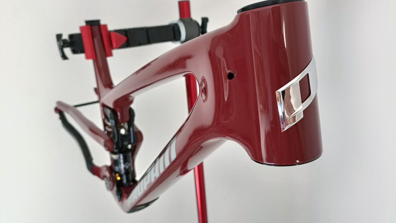

The current model Tyee is now 3 years old, and far from bleeding edge in terms of geometry. Although I was gelling well with my LLS Bird Aether 9c, I was curious to try some more travel. The reach on this XL frame is a full 50mm shorter than the Bird. I have pursued aggressive geometry by immediately fitting a Works Components angleset to reduce the head angle by 1.5 degrees. It is now sat at 63 degrees. When paired with the longer forks this means the wheelbase of the two bikes is pretty similar.
The headset was the first job, and quite simple to fit. Second was a tedious Ride Wrap job. I doubt anyone enjoys that job. There are a handful of small bubbles, so it’s not cosmetically immaculate, but it is at least functional. I made an error by leaving the frame in the workstand overnight clamped by the top tube, which rucked up a big crease. This took another half hour to fix on the second day.
I needed a new rear brake mount, which a local shop was able to supply.
The new air shaft in the Lyrik was a very simple fit, and gave me chance to complete an overdue lower leg service.

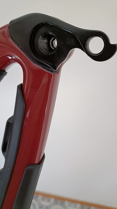

I mistakenly fitted a 6mm offset chainring, and foolishly modified the chain device to suit. The old cranks are pretty battered anyway, and the BB is on the way out. I don’t like the DUB stuff, so I have new cranks (Unite, silver), BB (Hope), chainring and chainguide on order to make this area a bit smarter.

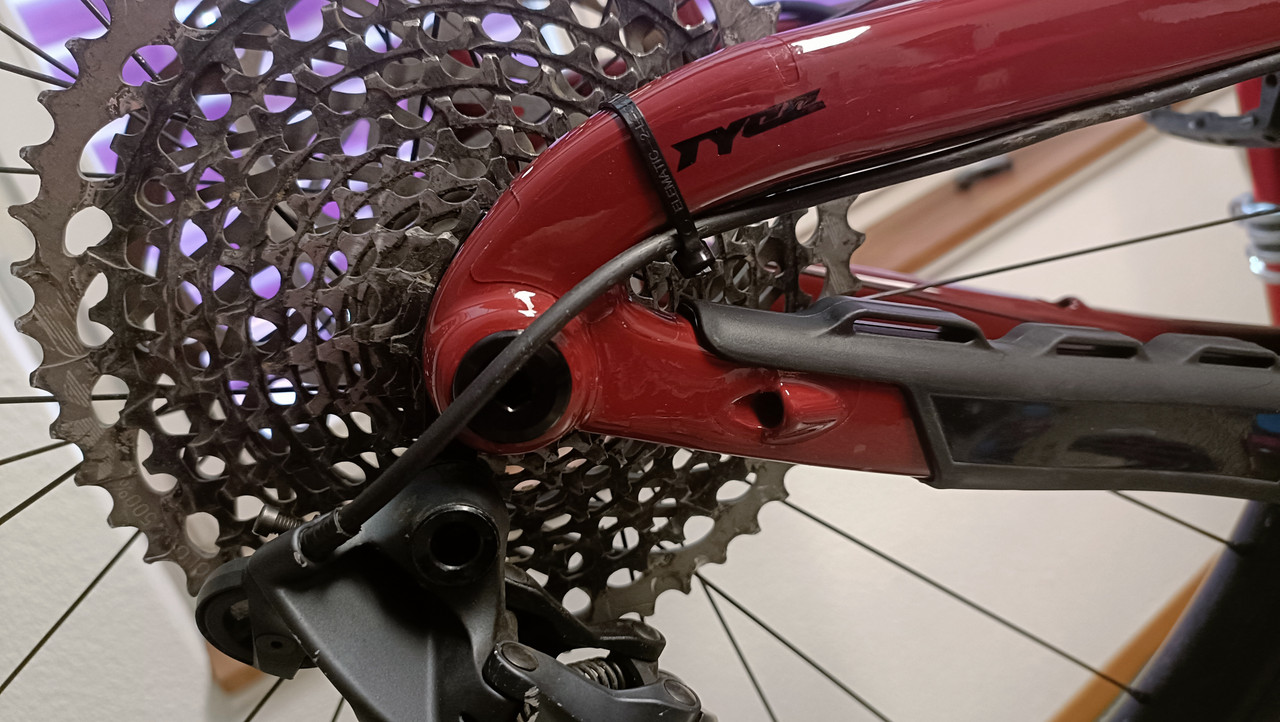

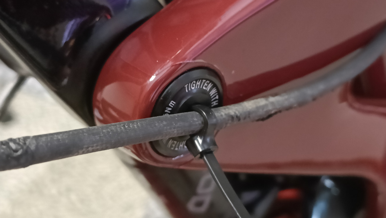

One widely reported niggle of the Tyee is the cable routing, which is internal in downtube and chainstay, but needs a loop of slack to remain under the BB. Here the cables are prone to damage from rocks, and can be a source of noise as the suspension moves. This is exactly the same as the Aether 9c. I have bypassed the issue by just running the gear cable and brake hose externally with cable ties.

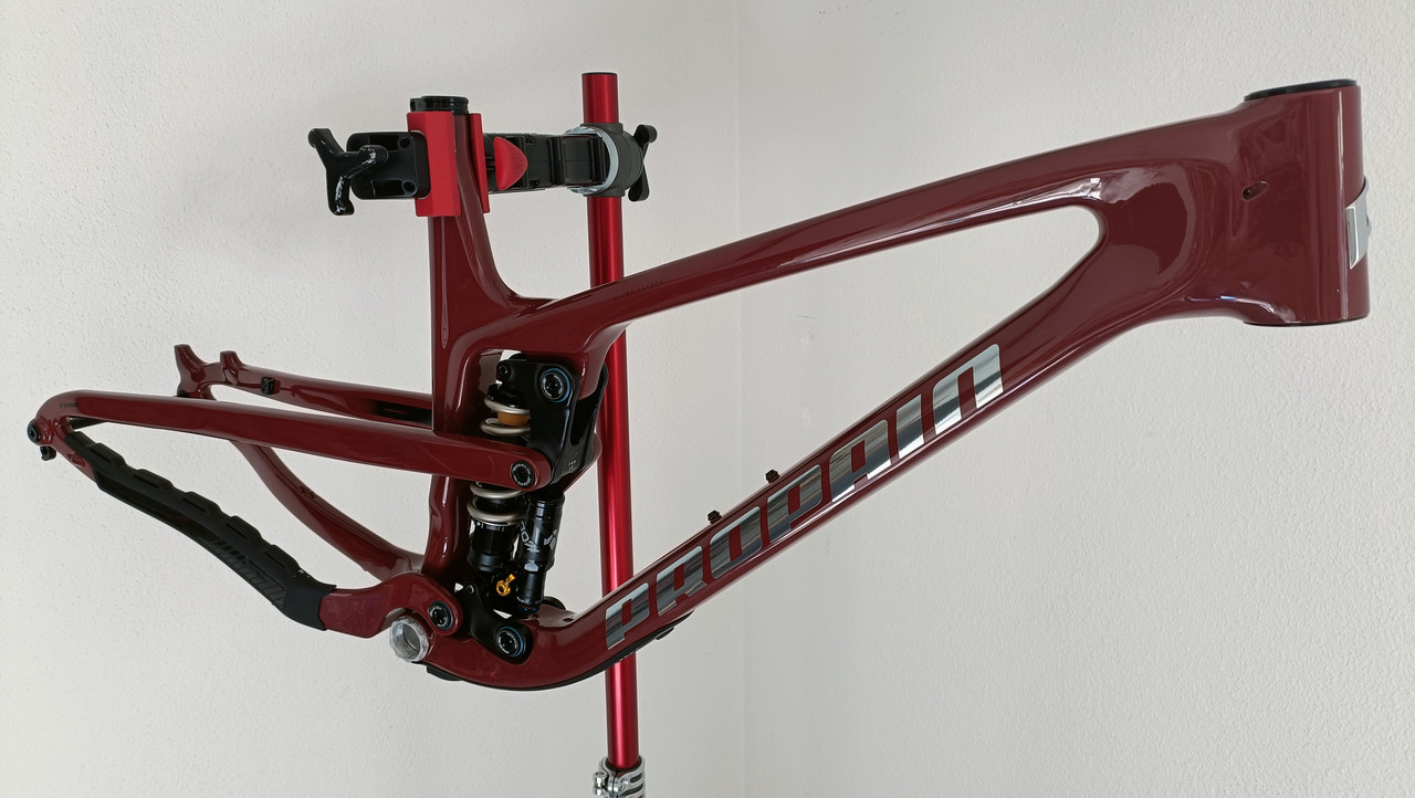

I am about 90kg fully kitted up. I went for the 550 spring on the Formula Mod shock. He shock has very tight clearances, but can be removed on it’s own with some manipulation. The adjusters are out of the way, but reachable.
The frame and shock and headset and seatclamp weigh 3.95kg together. The shock and spring are 800g of that.
I am 190cm tall. I have fitted a 213mm BikeYoke dropper. The collar of the dropper is 40mm from the seatclamp. The actuator of the seatpost must be rotated in a particular orientation to fit past the flat part of the seattube, but I could run the post at least 10mm lower if I needed.

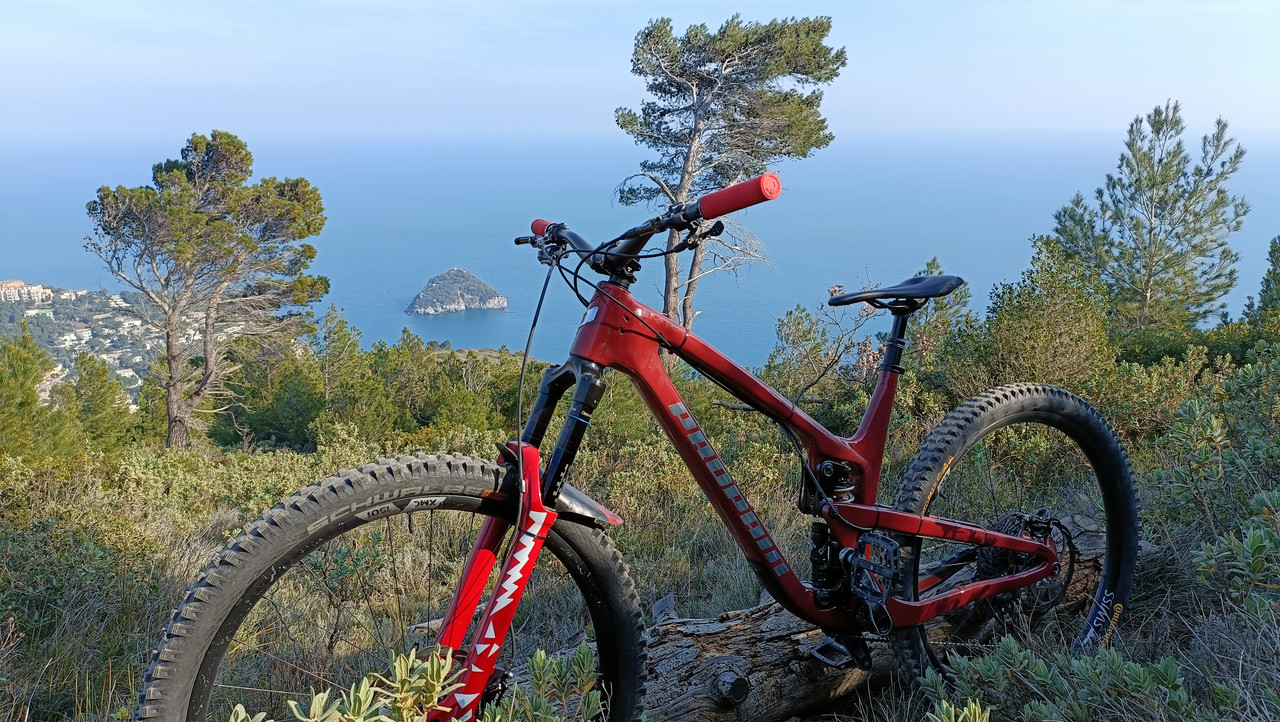

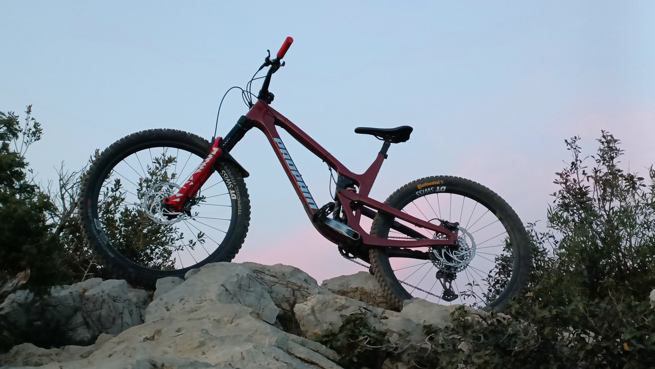

The frame arrived on Wednesday, and with some work I was able to get it completed in time for a planned trip to Finale on the weekend. That delivered some intense and memorable first ride experiences, and also some nice photos.
I will come back later with some initial ride impressions.

I've got home now and stuck the bike on the scales. 15.2kg = 33.5lbs
Current set up with a Schwalbe Magic Mary 29x2.6 Super Trail on the front, and Continental Kryptotal 29x2.4 Enduro casing on the rear. No Inserts.

I'm a little concerned about the cable/hose when deep in the travel, would running them down the downtube and above the BB not be better or is the linkage a trapping hazard, the frame design really doesnt help to achieve good routing, I totally agree about the loops under the BB shell, propain need a re-think about routing.
Posted : 30/03/2023 2:29 pm
Posts: 774
The current route along the seatstays is tested without the shock in place. It's not perfect that the cable does a S bend like that, but it seems to work ok.
Propain have 'fixed' the routing on the more recently released Spindrift and Hugene. There the cable pops out from the the top surface of the bottom of the downtube, and then enters the chainstay behind the chainring.
I can not mimic that route without because the the cable is very close to the tyre or the chain.

I have just had the pleasure of opening the pivot and checking the bearings. I am impressed at the general design. It seems robust and easy to work on.
The shock bolts are single piece, steel. They are easily removed without a punch.
There are 8 bearings in total, all a good size. Only two types to stock. They are all pressed in to the aluminum links, which means that they can easily be removed to the bench when it comes to the time to change them, and all cable routing can remain in place on the bike. There are good notches at the back of the bearing to access the outer race with a punch. The bearings are Acros branded, and seem to be stainless steel which should last well.
All the pivot hardware is aluminum. They are 'plain' axles, with split wedges to hold angled recesses in the carbon holes. There is a bolt on either end of the axle. There are no threads in the frame.
On the two pivots where the links with bearings are 'outside' of the carbon frame, there is a additional seal under the bolt head. The pivots were assembled with plenty of grease. Just one of the bolts seemed a bit looser than the specified torque, but they are simple to check. There is just one down behind the chainring. This can be checked with either the crank removed or the shock removed.
I like this arrangement a lot. More parts than a Santa Cruz for example, but they are nice simple pieces, and no threaded elements in the frame like that either.
