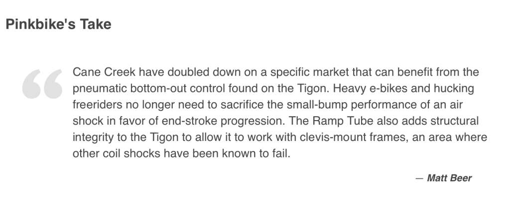

as part of the pink bike article i've discoverd Sprindex https://sprindex.com/ for that oh so in-between spring rate.  No idea how it works, but anything for some more weight (is't that the in vogue thing now)..
Posted : 31/10/2023 2:21 pm
Posts: 29577
What I don't get about the Sprindex.. is that in effect it's making the spring shorter, isn't it? So unless the spring is already designed for a longer stroke than the shock... you'll get coil bind before full travel, won't you? Someone crack open the maths/physics...
Posted : 31/10/2023 2:39 pm

IMG_1735
I am probably being dumb - but isn’t the benefit of coils that they give better improved small bump sensitivity - not worse.  Air shocks are far, far better than they were since they introduced negative springs - remember the old Fox Alps air shock,  huge stiction.
Posted : 31/10/2023 2:49 pm

i don't think they've messed with the small bump element as the air part is between 0-30 psi only and only really kicks in towards the end of the stroke.
Posted : 31/10/2023 4:00 pm

i don’t think they’ve messed with the small bump element as the air part is between 0-30 psi only and only really kicks in towards the end of the stroke.
The pressure isn't really the issue with small bump on an air shock, sure it'll need tighter seals to deal with the higher pressure and that effects stiction but any seal will give that.
The ramp on that is also going to be massive. end stroke on a coil shock is under a huge amount of pressure already, for 30psi wouldn't result in a perceptible difference unless it's undergoing a huge amount of ramp, so you're still going to be dealing with many 00s of psi at the end of the stroke so still need very tight seals.
I guess the air portion is active the whole time, the reason for the low pressure being it's not until very late in the stroke that there's a noticeable impact on the spring rate but, that means the seal stiction needs to be overcome at the outset of the travel.
The other option is its completely isolated from the coil until the last ??Mm of the stroke, at which point the stiction won't be noticeable, but that needs a tiny air chamber to allow it to ramp from 30-noticeable before bottom out which will mean getting the pressure consistent and accurate is incredibly difficult.
It's a bold move trying to make a coil shock that behaves more like an air shock but I don't really see the point.
Posted : 31/10/2023 4:24 pm

The other option is coil shocks with an hbo. The Pinkbike review suggests that this CC shock works better for them than a rockshox super deluxe with an hbo. <br /><br />
That said - I imagine this is going to be more expensive to service / need servicing more often due to the air aspect of the shock…..so I’d be more tempted to go super deluxe or maybe ext I think.
