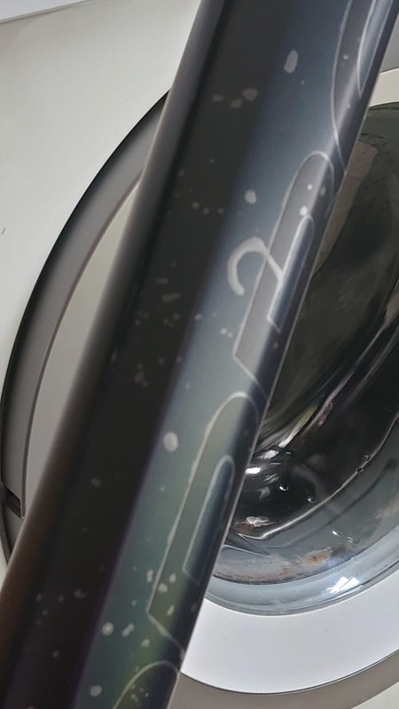

Not my bike, this has been fitted to a new frame. Buyer was advised to give it a week to let it dry out
opinions?

How long ago was it done? I'd not be happy about that if I'd paid, or of i did it myself.
Especially on the top of the top tube when you can see it on the bike.

I did mine myself, I wouldn't have left bubbles like that on my bike.
It's probably already dry, so short of removing it with a hairdryer it's probably going to stay like that?

Seems fine to me.... But i'd buy it for the protection not for it being aesthetically perfect.

I've only ever done this to my own bike and that sort of finish is pretty hard to avoid. If this is the work of a bike shop its a bit messy. Not sure i would be happy if i paid good money for it but at the same time if i worked in a bike shop i would either refuse to do it or warn that the result is generally a messy looking bike.

Hard to say as crap photo, if those are tiny air bubbles not dust or other debris then yeah they may well disappear over time.

Shop supplied and fitted, not seen in the flesh yet, maybe tonight. The shop keep batting it back saying it will dry out. I'm not convinced as it will be dry now as its been more than 24hrs since it was fitted.

From what I can see, there are 5 air bubbles, 4 in a square shape, another lower down near the seat? I did my new Tyee a few weeks ago, second bike I've done now. I ended up with 1 air bubble that I found on a real close inspection. No, they don't disappear after time. I managed to get rid of my bubble my getting a pin and sliding into the edge of the bubble and giving a firm rub with a cloth towards the hole. No evidence of the hole and bubble gone!
For what its worth, if I'd paid to have that done professionally, I wouldn't be too chuffed.

I’m not convinced as it will be dry now as its been more than 24hrs since it was fitted.
if they're air bubbles then they probably will disappear over time as the vinyl is porous, but it'll be days/weeks not 24hrs. If it's actual water/liquid in there... not sure... but you really shouldn't get bubbles like that with wet application anyway.

Unsure what comes in the install pack these days but back in 2015 it came with a wee squeegee type thing that once the tape was installed, you dragged along it to remove the excess water but also move any air bubbles to the edges and then remove them. Installation can be straight-forward if you have a lot of time and patience, I'd guess a bike shop is short on both so it isn't such a time-consuming job, so it might not be as carefully installed and then 'squeegee'd'...
However, I've seen quite a few bikes invisiframed since then done by individuals and by shops and some of the finishes do appear to be hit or miss in terms of amount of air bubbles that are left. The ones that look like there is no tape over the bike seem to be the ones done by individuals with plenty time and patience or by shops that seem to do a lot of them.
If I'd paid someone to do it I'd be unhappy but probably not unhappy enough to look to get it redone. If it was myself, I'd be annoyed that I didn't get it sorted and may try and fix it.

I’m with Weeksy on this. I’d also possibly get a hair drier and pin but would probably just ride it.

brand new bike? if so then not acceptable.
ridden bike. your lucky its that good

I'd refuse to pay for that, tbh. Doing a crap job of it yourself is free, you're paying for it to be done right.

I’d not be happy with that if it’s on a new bike. It’s hardly rocket science putting it on, just takes patience & good prep.

Yup its a brand new bike. He paid £130 I'm guessing that includes the kit

I'd be complaining - as far as vinyl goes invisiframe is relatively easy to install.

If the bike has a matt finish to start with, you'll often see the above as the finish itself won't be that smooth.

Not good enough, matt or gloss finish there should not be that many huge air bubbles.

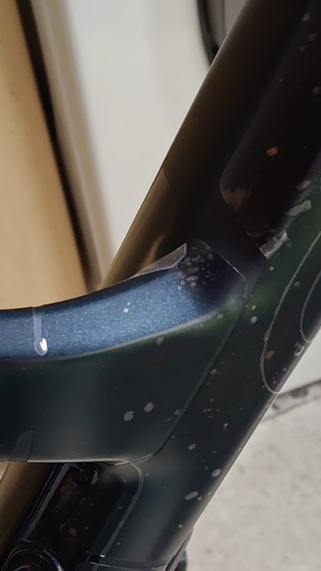

Been sent a couple more pics not using the potato cam. Its really poor
Posted : 30/04/2021 5:54 pm

Well that looks much worse than the top photo. Reckon I could do a better job and I’m a cack handed fool.

That looks worse than what I'd do...

That's absolutely bloody shocking, I wouldn't be paying for that. Had my Occam done by the shop when new and it took me a few seconds of looking to see the Invisiframe at all, it was essentially completely invisible and still is a year later.
#Edit: Quite aside from it looking terrible, in that state the dirt will get under it where it's peeling at the edges and it'll start peeling off in just a matter of weeks.

Ah, those pics look much worse.
I was originally going to say it didn't look too bad, but it looks awful in those pics.
I wouldn't be paying for that. Even the edges look crap.

I would not be handing over a penny for that. The clue is in the name.... INVISIframe. Not HUGEGREATBIGBUBBLESVISIBLEFROMSPACEframe.
More bubbles than a mint aero!!! Did they just throw it at the frame and see what stuck?

Id be sending those pics to Invisiframe and asking if the shop is an approved installer!!

That's a tragic job.
I did my own first time, took about 4 hours. Was nowhere near that bad with just a few bits of dust and odd tiny bubble.
I'd be straight back to them

Totaly unacceptable. Tell them to re-do it properly or give you your money back.

Thing is, what if he makes a shit job again? How many chances do you give
They are not on the "list"
He emailed invisiframe asking their opinion, Lee called him to say it wasn't acceptable. I'll update once I get full story from him

I'd get the money back then take it an approved installer with proof of good work.

Is be be genuinely embarrassed for that to leave the shop if I attempted to charge for that.
Looks like a rushed diy effort at best and I suspect most diy applied kits are better than that.

I take my comments back. Yep that's a shocking job.... and be very very careful removing it. Make sure the tape gets heated before being removed....or you'll pull your paint off. I did that on a custom frame a few years ago with a hugely expensive paint job. Cost me about £500 to get it fixed.

That second photo shows it’s an awful job. I’ve got limited patience but did a much better job than that with just a roll of 3M tape, a pair of scissors, tape measure, water spray, plastic card and a hair drier. It’s not invisible but only a few bubbles I can’t get out.
It’s certainly not going to dry out and fix itself on its own like the bike shop are saying 🤣

Yeah, I'd be taking it back and getting them to remove it and fix any damage in fixing it.
That's a terrible job.

Update: after contacting invisiframe to get their opinion on it they have sent another kit FOC to bike shop. Well done them I see no requirement for them to do this
Against my advice The bike is back at shop today for removal and refitting. Shop said they would refit FOC 😂 'kin right you will

That is shocking, really detracts from the finish of the bike, if the bike came to the shop like that for example with bubbles under some decals or marks on it surely they would reject it.
Never seen so many bubbles in one section of wrap.I might be unlucky to get one or two over a frame send I’m terribly kack handed.
