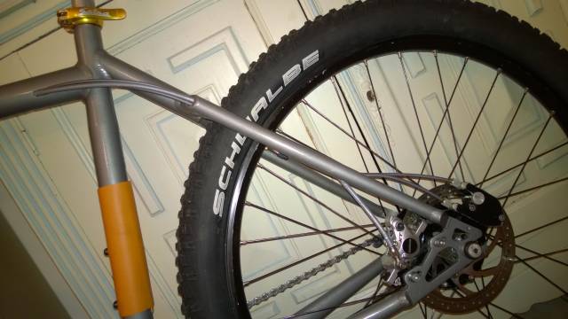

So, the silver thing is the external mech. For those that don't know Rohloff's, the external mech is mounted outside the non-driveside dropout like this:
The Kindernay mounting is much slicker, as it sits within the drive-side dropout:
The only downside is asthetic, as if your cable routing is up the seatstay as mine is, you have to leave some slack in the hoses so the wheel can be removed downwards (then the shifting box just slides off the axle)
If you have chainstay routing, it looks almost invisible:

with the rohloff you can alter where the shifter mech sits to have it behind the axle with the cables running up the seatstay if you want
Posted : 31/07/2023 8:36 am
@tjagain, I wondered about that, but was a bit concerned that would leave the box susceptible to water ingress through the cable entries?
Posted : 31/07/2023 8:50 am
Never thought of that.  The box is alloy and brass mainly but even so water could be an issue.
If the disc caliper is between the seat stay and chain stay you could even have it above  the axle
I do like the fact the kindernay uses stock disc mounts tho - although one really crafty thing with the rohloff is that the disc mounts are the same spacing as a granny ring - so if the hub fails you can flip the wheel and put a granny ring on the disc mounts as an emergency "ride out of the wilderness" bodge - it would be a fixie tho 🙂

...as if your cable routing is up the seatstay as mine is...
At least it means you can use the cable guides if they run along the right seat stay!
...but was a bit concerned that would leave the box susceptible to water ingress through the cable entries?
I had this geometry on my previous Rohloff build based on an On-one Scandal, don't think I noticed water ingress, but I also added some heat shrink at a later point.
Rohloff cables at top of seat stays

I’ve got a Kindernay too. I’ve had it for almost three years but only just built it all up with a Gates belt. It took a slight modification as the lock ring sat too proud for the shifter attachment. But other than that, it’s now working great.
BUT, and it’s a big but for someone who likes a quiet bike…it’s DAMNED noisy. Some gears (lower) it’s almost silent. Higher gears it sounds like your freewheeling even when pedalling but not too bad. Though the middle gears that you’d use for most cruising around sound terrible. The hub uses effectively straight cut gears and as we know from racing cars with straight cut boxes, they are noisier. But on a bike, I’m not sure I can cope with it.
tell me, did your hub get any quieter that you noticed? Of course at the expense and now building a wheel I’ll persevere for a while. But I have a niggling feeling I’ll eventually swap it out for an XTR drivetrain at a lower weight and lower (although now additional) cost if the noise remains this high.
IMG_3361IMG_3358
