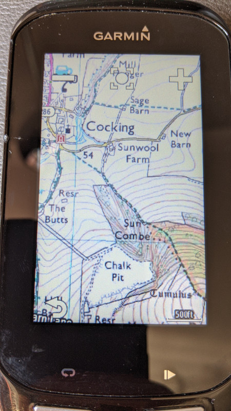

Got my Edge ready to put on Ebay. Took this photo
Powered it off. Removed the micro SD. Powered.. erm, tried to power it back on. Dead. WTF?! Winding me up to the very end!

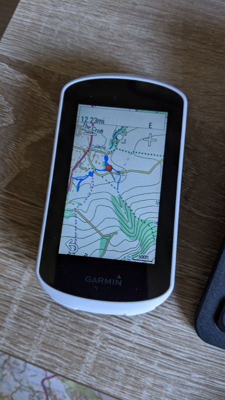

Help meeee... I’ve got OS mapping on my Edge 1000 (oh, its working now) and i dont remember how i got it on there. Its on the sd card. How do I get it on the Explore? default mapping is rubbish.
Posted : 13/09/2020 1:17 pm
Posts: 3197
Hmm. I am interested in this too as I have ordered an Edge Explore and will be most familiar with OS mapping.
Posted : 13/09/2020 2:14 pm
Hmm, lotta dosh, but ...
https://shop.ordnancesurvey.co.uk/activity-gear/os-collection/os-gps-devices/os-trail-2-gps/
Posted : 14/09/2020 10:24 am
You buy it on an SD card.
I had OS maps on my Edge Touring and ended up selling them on, because they were bitmaps and when you zoom in you just get pixels. I found the Garmin mapping (which is Open Streetmap based) to be much more useful tbh. The only downside is that you can't see what's a RoW and what's not. But otherwise it was better. I do consult Backcountry Navigator on my phone if I need to know about RoWs.
Posted : 14/09/2020 10:37 am
Millions of Google results later, I find this
https://www.the-thorns.org.uk/mapping/help/ukgarmin.html
£15 for whole of UK. I shall report back
musta been an issue with the Touring, or the maps you had (zooms in a lot closer)

Yeah it had a small low res screen, for sure. But maybe I'd bought the 50k maps rather than 25k? I don't remember now.
Posted : 14/09/2020 11:18 am
Edge switches between the 50K & 25K pretty seamlessly when you zoom (Just wish I could remember where the hell I got the mapping from!!)

Got the OPENGB maps from the-thorns.org - heres a screenshot to compare with OS above. Similar area.
The contour lines are a bit too bold, but apart from that looks nice, should be easy to follow.
This seems to be the Garmin way to buy OS (style?) area mapping - https://buy.garmin.com/en-GB/GB/p/86339#overview 3000km2 for £20
