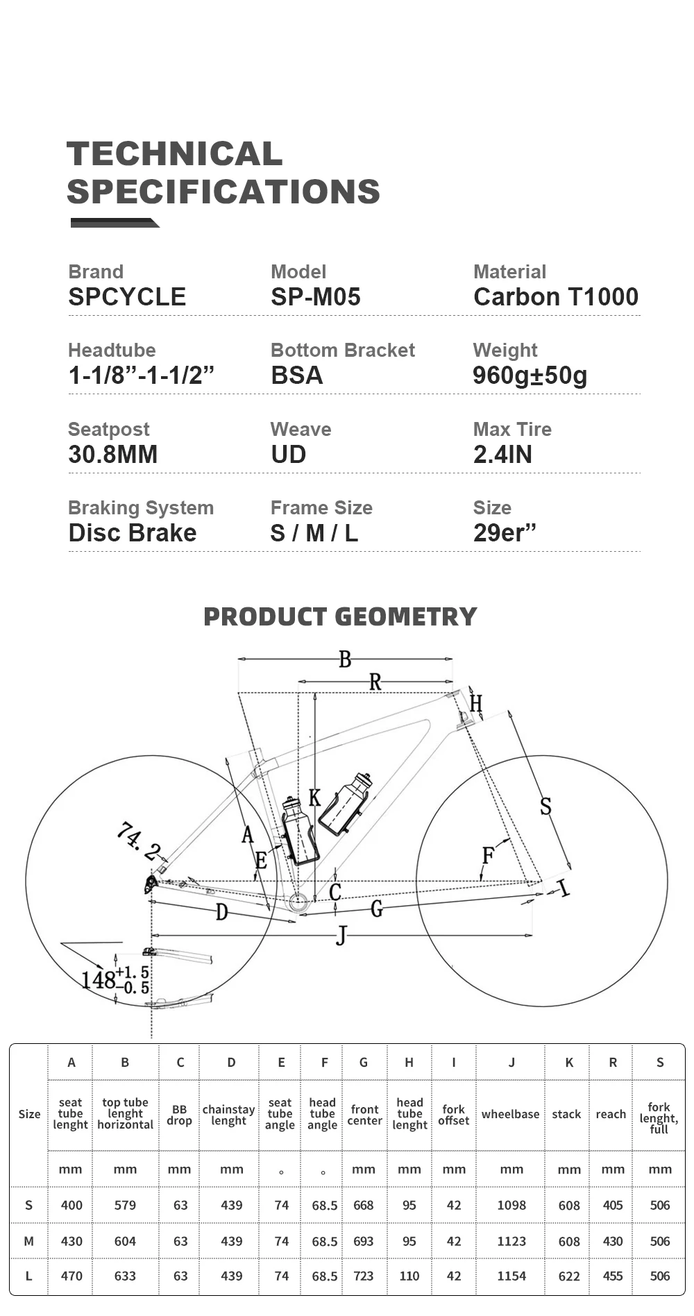

Geometry is almost identical to Trek Xcaliber, as far as I can tell.

Its a copy of a SB highball right? And their T1100 hardtail looks to be the same geo as a Epic HT, but seems overpriced compared to the SpCycle SP-M05 (looks to be the same frame).

Looks like a sc highball copy.

69deg is still pretty average.
Personally I'm struggling to gell with longer/slacker geometry clipped in and on the rivet. The slightly nervy descending is made up for by the front wheel grip on tigter single-track. I don't have the same issue on a trail bike with flats though. I think it's just that fractionally different foot position and how it affects weight distribution.

I really like the look of these, I just wish they did one with more progressive geometry.

I was after XC geometry and this frame is very similar to this year's Trek Xcaliber although Trek has 71.9 head tube angle whereas the Airwolf has 69.5. That suits me fine.

I was after XC geometry and this frame is very similar to this year’s Trek Xcaliber although Trek has 71.9 head tube angle whereas the Airwolf has 69.5. That suits me fine.
Nah - you've quoted seat tube angle (which seems slack?) - both are 69.5 ha.

Both the T1000 and the Xcaliber have seat tube angle of 73.

100/120mm the geo is the same as a santa cruz highball

I'm seriously tempted to take a punt on one of these as a 'winter project'. Someone mentioned the SpCycle SP-M05 somewhere up above - looking at the Geo chart it's a bit slacker than the others:
Geo
It's quoted as 68.5 HA - but if you look at the fork axle to crown (506mm) that equates to about a 100mm fork (RS Recon Gold RL 29" 100mm travel = 508mm A2C according to https://www.sram.com/globalassets/document-hierarchy/service-manuals/rockshox/front-suspension/gen.0000000005952-2020-fs-oil-air-coil-token-specification-english-rev-a.pdf)
If you feed the numbers into https://bikegeo.muha.cc/ and change to a 130mm fork, you end up with:
Geo
Is this going to make it ride like a pig, or am I reading too much into it?
Posted : 20/10/2021 10:29 am
Yeah I looked at those and they are a fair chunk more expensive.
I wouldn't be putting more than 120mm on one of these frames really.
But fit and feel is fairly personal, lifting the front will a) raise the bars b) shorten the reach c) slacken the seattube d) raise the BB
If it has plenty of reach b) is no problem, c) you can slide the seat forward on rails its only d) that will make the bike unmanageable.
They are also fairly XC frames, with short chainstays, so I think maybe turning them from XC whippet into trail monster is pretty unrealistic, but who know might be your perfect bike.
Posted : 20/10/2021 12:28 pm
