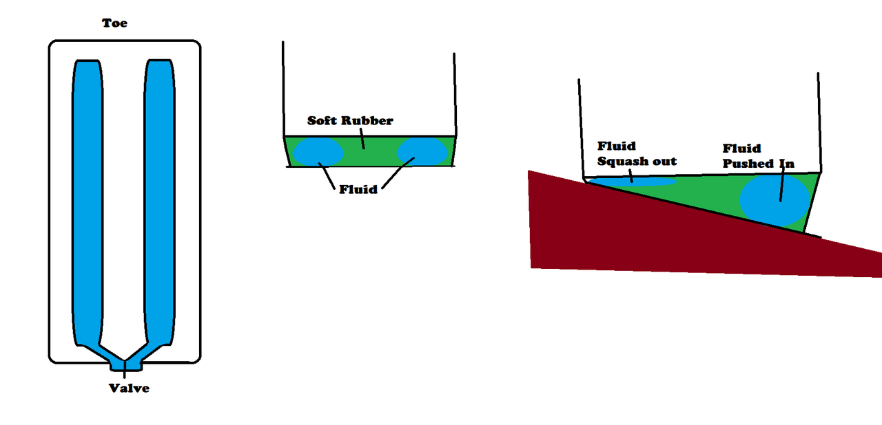

I have a fused ankle which makes walking on pavements which camber towards the road (almost all of them) difficult. Because the leg is always perpendicular to the foot base, when the ground slopes sideways to the direction of travel I get 'steered' down the slope which is normally towards the road.
I think it would be nice to have my foot level in the shoe while the sole of the shoe it angled to match the slope. The angle of the slope changes all the time so the shoe sole would need to adjust accordingly. Soft rubber soles sort of do this but not well and they also spring back as I lift the foot pushing me even more violently into the road.
If I put two deformable tubes filled with a thick fluid joined together through a valve, to control the rate the fluid flows between the two tubes, I think the uphill side tube will squash the fluid into the downhill side tube so that the innersole of the shoe would be more like level while the outer sole would match the slope of the pavement.
This only needs to angle a little bit as the camber of pavements isn't massive so I wouldn't need really deep shoe soles to fit this lot in (I think). The picture tries to show this.
Does this look feasible?

How are you planning to allow the tubes to change volume? What will they be made of?

ton - I have looked at various insoles like that and they help keep the foot supported but they don't help with off camber surfaces.
The trouble with my foot is I stubbed my big toe quite hard which snapped the bones and broke the joint where it meets the fused ankle. This also pushed the other toe bones out of line and snapped a couple of those so there is not much strength along the length of my foot and pretty much all my weight and balance depends on my big toe now.
As I said, I stubbed it quite hard

To expand on a previous comment, I think you’d need a rather soft foam sole, to support the flexible chambers.
Also rather than a valve, if you had a suitably sized orifice between the two chambers, and the connecting tube was blocked every time you put your foot down/applied a force, I think you could have a rather stable shoe which could adapt to different cambers in a footstep or two.
Not sure on longevity of all though, but I guess Nike manage.
Edit: thinking about it, the two chambers would equalise in pressure, so al a long as the flow rate between them is controlled, it could be quite stable anyway

Curved style doesn't give much support to the foot as it will roll from side to side. I want a solid, flat platform for the foot and a solid flat platform touching the ground but the two solid flat platforms are not Alsager parallel and the angle needs to automatically adapt.
I am not sure if the exact material for the two tubes but something like a bike innertube would work in principle.
I am thinking that there would be a hard wearing layer for the boot that touches the ground and for the inner sole with the soft material sandwiched between. It would this be protected from wear and tear and just get squished.
The idea of the valve was just to control the flow rate between cylinders. The liquid viscosity would help but different people weight different amounts and you may want to carry the shoes with which it adjusts.

My question would be if this works as intended, will it now feel a bit like a curved sole anyway?
Perhaps the valve or connecting link could be limited to only allows a tiny amount of fluid to transfer so it takes several paces for it to adapt to a new camber. I'm thinking the best point to allow the two sides to equalise fractionally would be when you start to lift your foot, because the ball of your foot would be fully weighted and as you lift your heel a squishy valve would open to allow say 5ml to transfer before a check valve/flap blocks the rest until the next step.

I am trying to work out how best to implement the valve. Basically I want it locked when you have your foot on the ground so that it is nice and stable but able to adjust to the camber at the same time. This isn't possible because of the damned time continuum.
I am thinking that as you first put your foot down there will be maximum pressure as the heel strikes the ground so use that part of the footfall to push the fluid through the valve. Then as your whole foot touches the ground the overall pressure is reduced as the load is spread so the valve closes and you have a locked sole position.
I am guessing this will take some fairly fine valve adjustment to judge the pressure for, perhaps, the first third of a foot fall while the level and angles of camber exert their influence and then being able to close after that. Liquid viscosity and valve tuning will take a bit of playing with I suspect but it seems possible.

I am trying to work out how best to implement the valve. Basically I want it locked when you have your foot on the ground so that it is nice and stable but able to adjust to the camber at the same time. This isn’t possible because of the damned time continuum.
I was imaging it was a non return valve. In effect you would create a pump that pushed fluid from the small to the large chamber. You would then need a return loop. - This would only work in one direction. You would have to walk back on the otherside of the road!

I want it bi-directional so I can walk on either side of the road or evev along the seafront without having to catch a ferry across the channel to walk back 🙂

You want a valve that remains closed when you lift your foot and open when it is on the ground otherwise the 2 chambers will act as one and equalise their pressure everytime you lift your foot.
If you use an orifice the flow speed is the same in both directions so when you lift your foot the fluid will flow back at the same speed as it entered the larger chamber.
Maybe a normaly closed valve that can be opened when the shoe presses down and springs closed when the shoe if off the ground. Not sure if this will work as the vavle is balanced so fluid could flow either way?

I think the time difference between the uphill tube and downhill side hitting the pavement will be very short, so I'm not sure there will be enough time for the fluid to move from one side to the other, especially as the valve or orifice will also restrict flow.

[i]But would it though…. As I thought your problem is that the ankle CAN’T roll (invert/evert)![/i]
That is the problem but the effect is that if the foot is not on a level surface my leg and therefor body gets tilted to one side and I end up walking that way. Having a 1/2 tube on the sole will basically mean I am walking on a very thin central bit with the chance of it rolling in either direction at any time so I could fall into the shop front instead of the road.
All - both tubes will be the same size but either could be inflated or deflated depending on how much fluid is pushed in or squeezed out.
I agree with Richmars point about the time the fluid will have to move. That is my main issue I think. How do I get the shoe to self-level quickly enough for the foot to be level and also stable when my full foot is on the ground. I am now wondering about making it very thick liquid so when I step down it is squeezed to make it level but very slowly and then will remain like that until the next step when it will get squeezed again. This means it will always be one step behind in terms of adjustment but as pavements don't change camber that rapidly it might not be a problem.
I might need some material scientist to join the thread to suggest the material for the tubes and a suitably viscous liquid.

I see what you're tring to do, but I don't think this will work easily. Your desire basically is to keep your foot on a horizontal surface, or at least laterally flat.
1You need to put down your foot flat exactly else you'll start pushing fluid around where you don't want it, and you say you weight bear on your big toe.
You want a viscous fluid, you think, but there are a lot of variables flying around. I don't like the idea of valves, and I'm wondering what fluid is going to work summer and winter.
You could try something like a Nike with a big air bad, as that can do this if you can tolerate the side force on the foot.

wbo - I also have my doubts which is why I shared the idea and asked for input. the good thing about having the foot fused is that is basically just a fixed bit of my leg bent at 90 degrees so it will always be put down 'flat'. The only angle that will change is the ground.
I started trying to design something like a bike pedal turned around 90 degrees. If you think about it, with a pedal, your foot can remain ad the fixed angle regardless of the angle of the crank arm. The troubles with trying that is that it has a single pivot, like the half pipe idea mentioned above, and there is nothing stopping the pedal spinning when I want some fixed stability. That is when I moved across to the two tubes of custard idea before remembering that custard in a non-Newtonian fluid so some other thick fluid would need to be used, perhaps gravy?
The valve is only there to allow adjustment of flow rate for thin or fat people, hot or cold affecting viscosity and wanting or not wanting the effect etc.

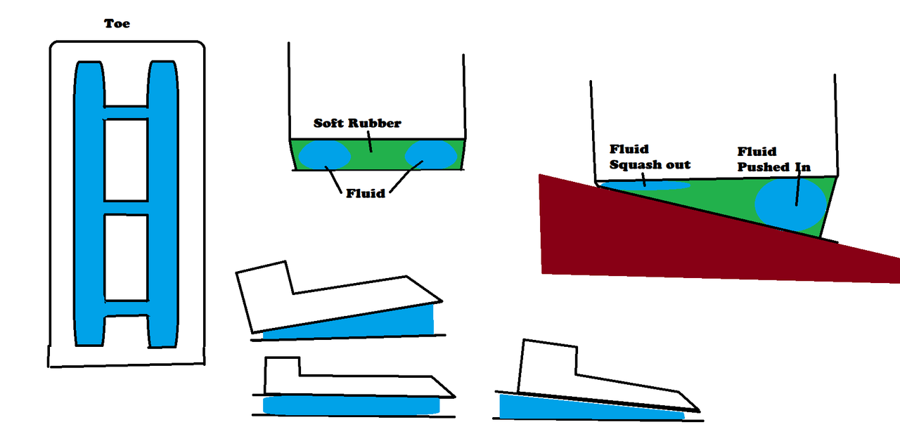

Slightly modified design diagram to cope with the foot angle, front to back, when walking. When the heel strikes, the fluid will get pushed into the front of the shoe, plus side to side as before, but as the leg moves to the straight up, the fluid will even out front to back and then finally get pushed to the back as the step concludes.
I have also changed the side to side flow to a few narrow interconnections but I think that an adjustable valve of some description will be required.

I wonder if you could achieve the same affect with a memory foam type material with a slow rebound property.

The trouble with foam like material, I think, is that to prevent the spring back, they have to be slow to squash. That is why you get uncomfortable 'pack down' when having sex on memory mattress. Also, there is much less control for lateral balance

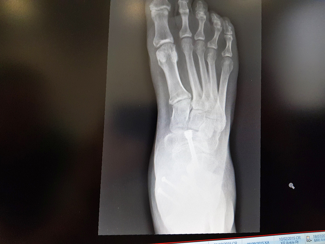

Thats xray makes my feet ache just looking at it.
Can't the bones be realigned?
As for your shoe idea, wouldn't a MIPS style insert into the shoe work better, allowing the ankle to rotate in the shoe like a 'ball and socket'?

But the squash is loaded and the rebound unloaded. Isn’t the packing down what you want in this situation?
If the 2 chambers are soft enough to allow expansion and contraction I think you will have a problem with lateral stability anyway.

However, have you seen the pictures of the x-rays in the thread? Could be a bit exciting with some neodymium magnets near those!
