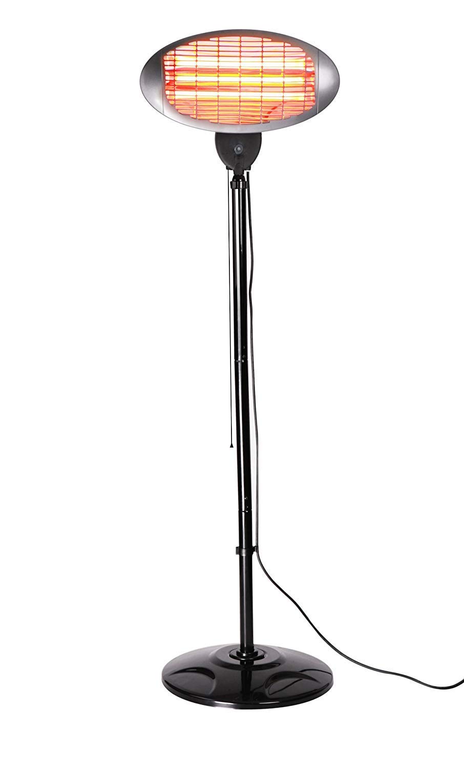

I've got a similar conundrum .
I work at a bench mainly, machines also in an uninsulated workshop.
I've literally just unboxed a cheap infrared heater from Amazon to try. Essentially a patio heater.
They're supposed to heat people and objects rather than the air, so hopefully not quite so much wastage.
We'll see though when I try it in the workshop.
It's made by Firefly, though obviously generic. Wall mounted for 30 notes.
