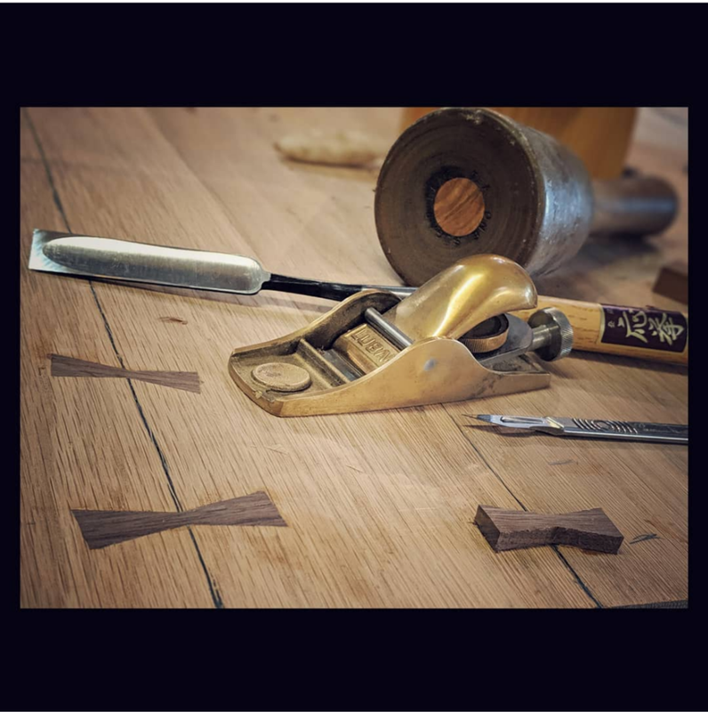

Joining the two in the middle shouldn't be difficult, and maybe even something simple like a butterfly joint in a contrasting timber.

Joining the two in the middle shouldn’t be difficult, and maybe even something simple like a butterfly joint in a contrasting timber.
This could look nice.
