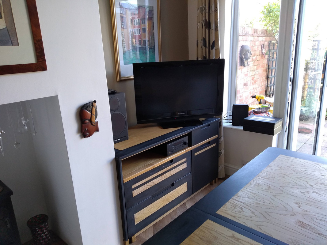

Posts: 10567
There you go, Bridges! Plenty of modern rubbish in there to feast your eyes on! Oak and Valchromat Extending Dining Table and Media Unit
An extending dining table, media unit and jewel box made of oak veneered MDF, black valchromat (HDF) and a few bits of solid oak.
An artist has to be able to have the ideas and execute them perfectly. A musician can play somebody else's composition and a songwriter doesn't have to know how to perform. I can get away with materialising my ideas without much dexterity.
Posted : 03/05/2021 2:16 pm
Not my cup of tea, but stylish enough.
This is my philosophy. I wouldn't ever be able to put a price on my own work, because when you consider hours spent on a piece, even a modest hourly rate would see pieces end up costing many thousands. My plan is to gradually replace most of our furniture; one problem is that there's quite a few original Mid-Century pieces, which are now worth a small fortune, so we could easily recoup quite a bit of value by selling and replacing them. It's nice having original stuff though.
This weekend, I decided to cut some halved housing joints by hand, rather than using a router, as most people probably would. Takes far longer than using a router (even accounting for setting up etc), and is perhaps not quite as accurate (not too far off though...), but it's the challenge I really enjoy. Really quite nerve-wracking (this Ash is expensive stuff), and no margin for error. I've actually surprised myself by how well I've handled it; the joints are almost indistinguishable from machine made, and to be able to achieve this level of craftsmanship, has given me a real boost, and some much needed confidence. I can now move forward to the next project, knowing 'I can do this'. And you just can't put a price on that.
Posted : 03/05/2021 6:11 pm
