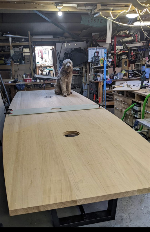

40mm isn't thin!
You'll struggle to lift that at that size.
If it were 18/20mm thick I'd say that's a bit thin but 40mm is a chunk.
I've just made a 4800mm long table which was 38mm thick and had fairly minimal supports and no underframe as such.
You could park a car/dog on it 😊
It was made in four sections, each one measuring 2400x800mm so longer than your desk. I could only just lift each section myself and I'm rock! 😉
At 1800mm long/wide and 40mm thick, I wouldn't be all that concerned about not having an underframe, unless your laptop is like WELL heavy.
It may sag a little over time but all those glue joints in a worktop are incredibly strong. Possibly more rigid than wood alone arguably. The added benefit of that style of construction is also that it tends to be less prone to warping because of all the glue joints
Put the legs as far inward as you can to lessen the span and you could always add a beefy batten at the rear, underside of the desk which would be fairly discrete. Maybe some kind of metal angle painted for added rigidity at the back instead, although I don't think you'll need it personally.
Be aware that any C-section or anything you bolt/screw in across the grain needs to be slotted to allow for timber movement.
Whatever finish you apply, apply it underneath too for balance.
Pics when you've done it 🙂👍
Posted : 24/03/2023 11:16 am

Thanks Kayak. Your table looks incredible 👍
That gives me a bit of confidence. Probably not going to happen for a few weeks but I like to have it all worked out before starting! Will return with pics!
