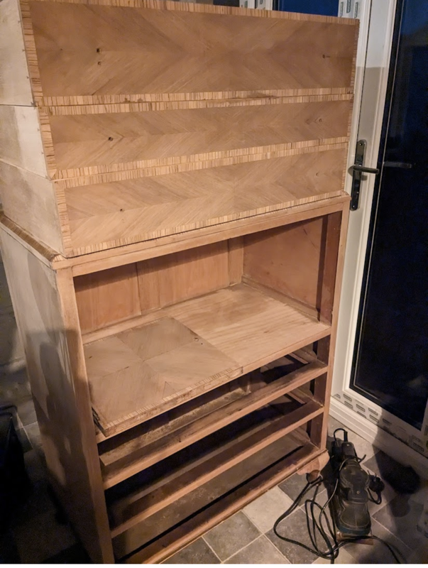

https://photos.app.goo.gl/UMoBBnnvb2djrB4C7
Not sure if the pic works but I've picked up an old cabinet off Gumtree, not looked after, door hanging off etc. annoyingly they had a massive plant pot on the unit which water marked the top veneer so much it's gone right the way through so the top will either need the veneer replacing, or painting (I hate painting wood)
I've sanded it all back, when cleaned with white spirits the veneer comes up nice and the frame work becomes a dark red, should I just use tung oil to finish?
I'd prefer something from osmo but want to bring the colour out rather than wax coat it and it becomes the same as it is now which looks slightly faded
I've never used oils etc so any advice appreciated

Op's picture below
You've done well to sand any previous finish off and not go through the veneer. 🙂
Always tricky when you don't know its history.

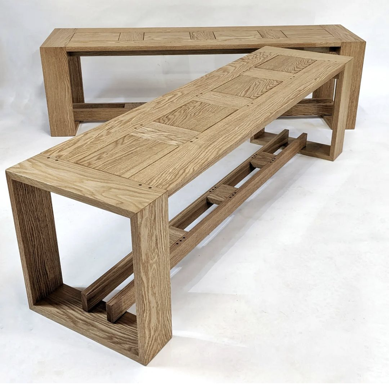

These Benches what I done are Osmo finished and I think the colour is lush.

Thanks Kayak, There's a few bits around the tops of the draw fronts I've bust through annoyingly, I was pretty forgiving around the edges too.
Osmo wood wax to finish?
The top was 4 A4 sheets of vaneer patterned similar to the fronts, I'm guessing iron on veneers will look crap?
It just needs to look tidy tbh, I'm not flipping it or taking it to the antiques roadshow
Posted : 15/04/2024 7:52 am
Osmo uv hardwax oil is what I used to use a lot.
Iron on veneer is rarely as durable but it can work fine.
Make sure you 'arris' the edges a little to prevent it catching and lifting later on.
