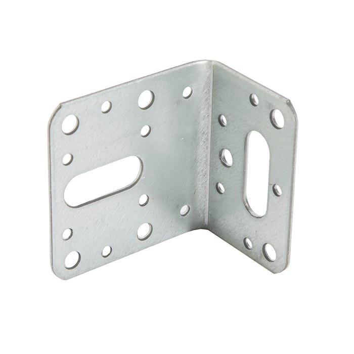

Simplest although not the prettiest (although you wouldn't see them) is use some of these on the inside of the framework.
It's not 90 degrees but the plates will pull to the angle.

^^^ I think He means these

You would be fine with either, although with brackets theres less chance of it coming apart, which dowels can do, due to shock breaking the glue line.
with brackets though they need to be the type above with slots rather than simple holes as timber seasonally moves by expanding and contracting. It moves more tangentially than longitudinally.

Pocket hole jig/screw on each rail breaks the fundamental principles of timber movement that Dyna-ti is alluding to above.
To be honest, timber movement isn't nearly the issue these days that it once might have been when timber Constructional techniques were being honed.
We all live in pretty stable environments these days what with central heating etc.
On top of that, it's a tiny stool. It ain't going to expand and contract a foot or anything.
It probably broke originally because it was cheaply made/mass produced and a kids stool so gets chucked about a bit.
Screw some mending plates on the inside of the rails and go on with your life... 😉
Align the slots across the grain if you must but in this scenario, I'd bet me granny that it won't be an issue if you didn't.

I opted for angle brackets on a similar stool we had that failed in the same way
