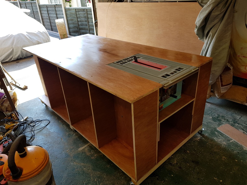

Now stuck trying to plan where to put it. My garage is a busy place. My main work bench is mobile.
That fills most of the centre free space which would mean a fixed bench near the wall which also means near corners. I guess a corner isn't a big issue for positioning a lathe other than for access around it.
Does all the action take place at the front? Do you ever need to get around the back or could I put it on a work surface against a wall in the corner of the garage?

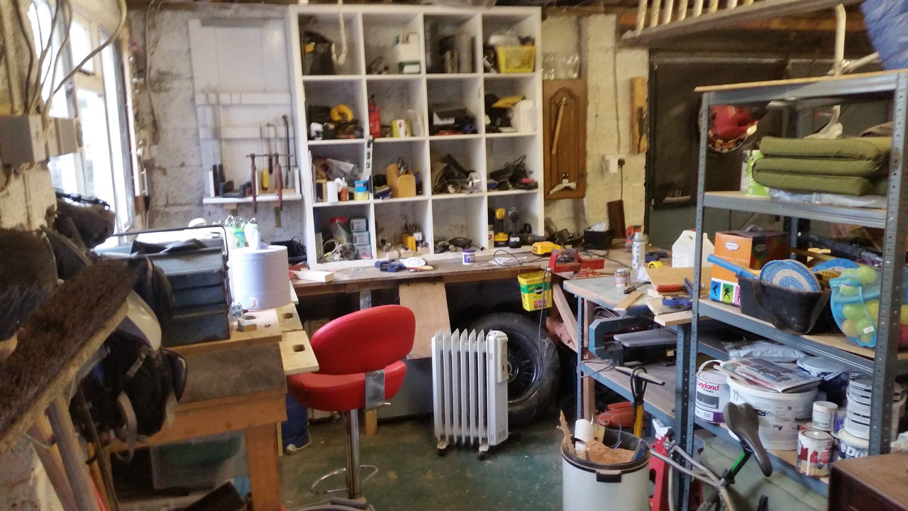

My garage walls from various time points but basically showing the point. It is a double width garage but with a single width garage door so this is the front wall with garage door on the right an a bench on the left along with a lot of storage. Ignore the shelving you can see on the right, that has all gone.
The right wall has more shelves and is where I wheel in and out the car/ work bench so cannot be blocked by another bench
The back wall is rest and relax after the Thursday night ride plus you can't see nearer you the bike storage and garden stuff
Which leaves me with the right side in front of the window. Of you ignore the throne you can see that there is a bench with drawers there already. There is also a window. A glass window. This would be the easiest bench to use or modify for use but
A) Despite the natural light, is setting a lathe in front of a glass window a BAD idea?
B) What is a good height to set a lathe at? That bench, because of the drawers, is a bit higher than I would have thought optimal but does it make much difference?

Mobile work bench isn't small

You'll need access from either for accessory removal. The drive and live centres are a taper fit in the quills and can get really stuck in there, so a knock out bar is used through the hollow centres to take them out.
Most knock out tools are in the region of 300-400mm. long.
Working height is a pretty subjective thing but as a rule of thumb keep the centre of the drives/chuck at elbow height and you won't go far wrong. You need to be in control of your tool so this is quite important as you'll find out.
In front of the window is an excellent place because when you're hollowing out bowls or whatever the more light available to see what's going on inside the better. It'll also take about 5 minutes of lathe ownership and use to realise that a clear space round about it for clearing up is essential. They're on a par with planer/thicknessers in their chip producing ability.

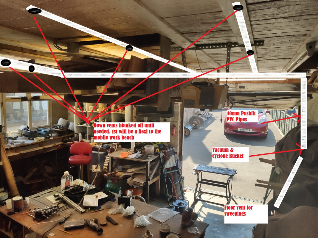

I am now thinking about putting in a proper dust extraction system ready for the lathe and to replace the 'temporary' system I put in a few years ago.
I plan to use the same 1600w domestic vacuum and cyclone bucket to collect the dust but connect it to some 40mm push fit PVC pipes mounted to the ceiling. There would then be down vents fitted where required over the benches and one on the floor to sweep dust into. Initially the down vents would be blanked off until needed. The moveable bench would be the 1st one and would be a flexible pipe that either connected to the table saw extract pipe or to the chop saw/grinder etc as required.
Any recommendations for easy flow closable vents so when I have multiple vents fitted I only open the one I need? Anything obviously stupid in the design? Do you think a 1600w Miele will provide enough suck - it works fine when stuck under the bench so I am hopeful.

Do you think a 1600w Miele will provide enough suck – it works fine when stuck under the bench so I am hopeful.
In all honesty, no. You'd be better off just using as local suction as and where you need it; by the time you added all the pipe the losses through friction and bends would be immense. As a rule chip extraction requires high flow but low pressure whereas dust extraction is the opposite.

Dust extraction think flour, Chip extraction think all bran or special K on steroids, 40 mm is to small for chip go for drain pipe, or again as above chip extractor for the lathe.
https://www.dm-tools.co.uk/product.php/section/6112/sn/RPWDX1000#.XpIORf1KiUk
Got one in the garage, works well
Posted : 11/04/2020 7:37 pm
Posts: 13369
Okay. what you say makes sense.
For dust, which ins most of what I make a the moment I need high pressure which is what the vacuum under the bench with Cyclone achieves. Moving it to the corner of the garage and having extended pipe would reduce its effectiveness.
Given that it over performs at the moment, the convenience of putting it elsewhere and having the roof vacuum and floor suction may still make it viable. At the moment the vacuum and bucket are under the bench, keep falling over, the pipes fall out and basically need fixing anyway. Reducing the number of moving parts that cause faults seems to make sense even if it is slightly less efficient
For chips I need a different solution.

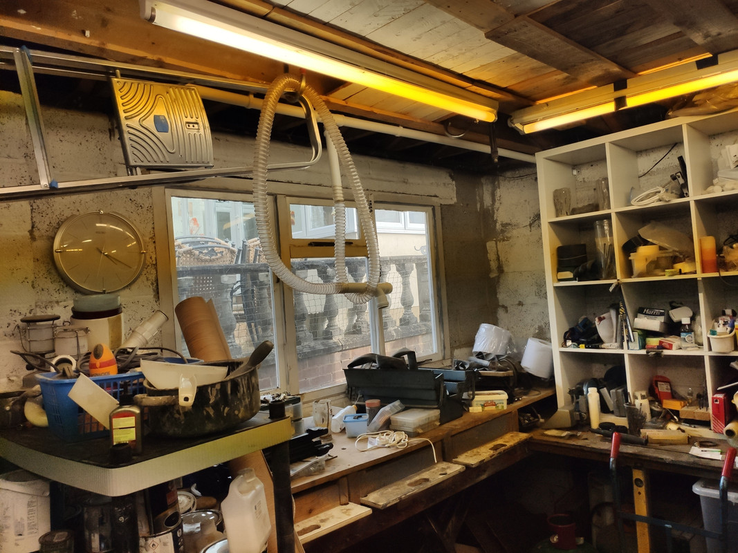

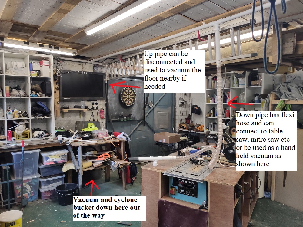

Dust extraction now in place but needs some cleverer way of storing the flexi hoses I think. It is currently plumbed to allow 4 separate hoses to cover all areas of the garage but only two in place at the moment as I don't need the other two with the way the garage is configured at the moment.
Plenty of suction as I discovered when the 6 little Humbrol enamel paint pots disappeared up it when I wasn't concentrating. They all made it safely around and into the bucket where I retrieved them. All white piping is push fit so can be opened up if there are blockages or I want to change something. If and when I get the lathe I will do something similar but bigger to cope with chips rather than just dust

If you connect one of the idle hoses to an upside down dustpan sort of arrangement you can sweep the floor up towards it and the dust gets hoovered up automatically. I made one out of ply, works a treat but you can buy ready made ones, can't remember what they're called, might be floor gulpers or something like that.

Great minds think alike.
I plan to make a ply one and fit it near the bucket which is one of the reasons I left the black up hose detachable.
