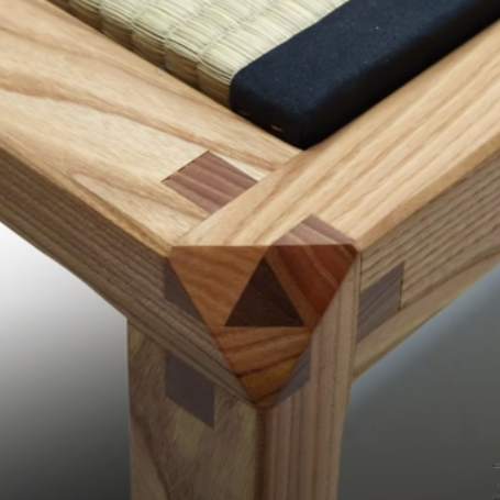

I saw this on YouTube and assumed it required 15 years of Japanese training.
This woman's video is create to see how to do it
Basically it is a mixture of cutting 2 or 3 units of measure from a piece of rectangular wood that is also 3 x 2
This shows the two sides of the piece you need to cut. All three pieces that join to form a corner are identical so set up a jig and blast then out.
Here is each side shown against the paper to try and make it clearer
It is amazingly simple and I banged out this prototype in less than 30 minutes. The joint is extremely loose as it is 3cm x 2cm and cut on a table saw without an aim for accuracy, I just wanted to see if it would work.

Yeah saw the other day.. Pretty cool except that you glue a bit in at the end, which kinda isn't really what you'd define as a joint imho.
Posted : 18/04/2020 10:45 pm
@Kayak23
No its still a joint, the extra bit is merely a capping piece for cosmetics. Having it there or not lends little strength to it
Think of it as applied de4coration.
Posted : 19/04/2020 1:58 am
The wee glue in bit offends me too.
Just leave the notch for an honest joint.

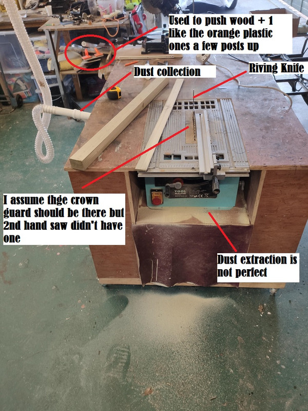

Who would believe it. I have almost all the safety stuff you guys recommend and I use it!
Kayak23 - I might try to do it nicely when I can get to the timber merchants. Most the wood I have stored is treated timber for outdoor work plus a sleeper like the one I made a seahorse from ( https://singletrackmag.com/forum/topic/are-you-bored-enough-to-watch-me-carve-a-sea-horse-from-a-railway-sleeper/)
Slightly less safety gear used during the filming of that 🙁

Find a top guard to fit if you can. Its surprisingly difficult to pick up you're own fingers 🙂  If you can't get one thats a specific fit to the riving knife there are stand alone ones that clamp to an arm reaching across the table
They make a really good difference in terms of extraction too  - most of the material goes down and is collected by the extraction (if you've got it fitted) or just falls on the floor. But a small amount goes up - mostly caused but the upward travelling teeth at the back of the blade lightly buzzing  the sides of the cut. Although its only a few % of the material created ( fit a stand alone extractor here it seems to  collect very little) its this fine stuff that ends up floating in the air and is what you end up breathing in. Either while the saw is in use because it settles on surfaces and is back in the air again whenever anything is disturbed.
Where you've pointed out in the picuture that the extraction isn't perfect... with table saws you get that - the way the blade has to articulate, tilt, rise, fall makes efficient extraction problematic. But the stuff that its settling right by the saw is more a mess rather than a hazard - its settled there because its big and heavy enough particles not to have been pulled way by the extractor. So your extraction is catching more the lightest particles, the heavier stuff has too much momentum as it comes off the blade for the airflow to grab it. Catching the fine stuff off the top is more important.

Wca as mentioned above, get a crown guard for your saw with a Hoover attachment or a split off the main hose and your dust settling will reduce dramatically.
