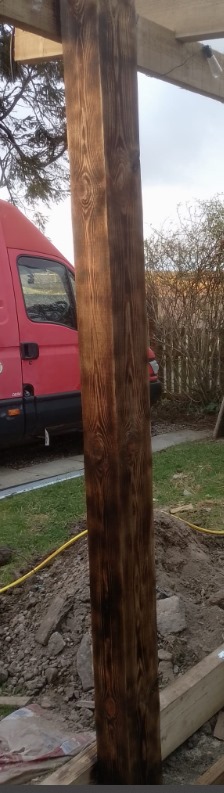

After much pissing about with offcuts.....
I binned the idea of stain. I sanded back the rough finish then charred the non description timbers grain and danish oiled the lot.
Gonna contrast with the floor being sanded flat  and epoxy varnished with sadolin PV67 and then jute rope joint stuffed
