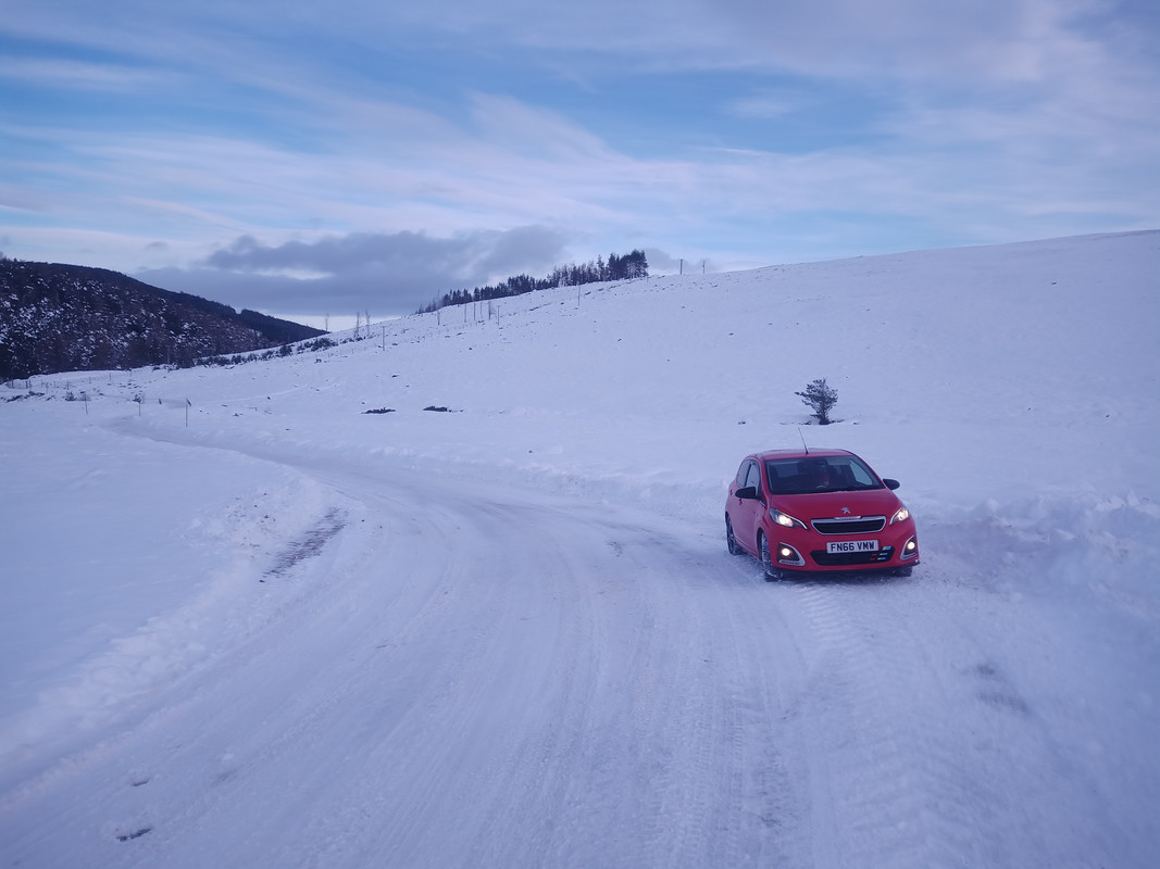

All season are designed for people in climates where snows are often necessary but don’t want the faff or expense of the annual swap, but their performance is too compromised
Can't say I've noticed much if any difference in performance between summer tyres and all seasons in the summer. I do notice a big difference in the snow though.
Posted : 19/12/2022 6:31 pm
And isn’t the whole point of ‘all season’ tyres that they make a small compromise on outright summer performance in exchange for greatly enhanced performance in winter conditions.
They do work admirably in snow/compressed snow/ice though.
Loch muick road on Saturday.
They also coped well today with the melt water on ice scenario..... My neighbours q7 on summers less so.
Can't say the 82 raging horses has troubled the all seasons in summer but certainly has no issues doing the speed limit.
Posted : 19/12/2022 6:42 pm
