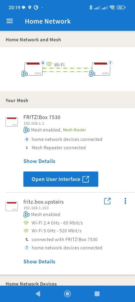

@sharkbait They definitely do a mesh system, I'm using one right now, and I'm using two routers as the router is cheaper than the dedicated MESH box secondhand. I think it's because people who are with Zen resell them.
Screenshot_2023-10-27-20-19-02-357_de.avm.android.myfritz2
