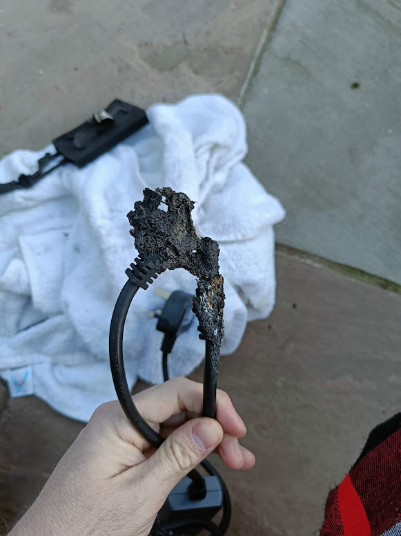

I had an electrical fire in the middle of the night just before christmas. Absolutely filled the house with thick black electrical/plastic smoke and popped the breaker in the mere seconds it took for me to leap out of bed and put it out (thanks to the smoke alarms).
The house was extremely difficult to navigate, i could not find my keys or torch despite knowing exactly where they were. I also fell over some baby toys (a walker and a baby bouncer) that had been left out the evening before that I *knew* were there. It was so disorientating. Normally you can see enough to navigate your house with the lights out (from moonlight, street lamps etc) but i could see *nothing*.
It terrified me that if it had spread to my staircase, it would have been impossible for my family to escape. My house is a semi-detached on a hill, therefore it's about an extra meter up as my neighbour's place is at ground level and the ground drops away as it goes under our house. I think you'd kill or seriously injure yourself trying to escape via an upstairs window, let alone trying to drop a baby out.
I reckon having a couple of powder extinguishers that could buy you a few seconds to get down the stairs would be well worth having.
I am also going to get a torch and extra set of keys cut and am looking into emergency lighting that comes on when the power goes off (not really to see with but so you can orient yourself).

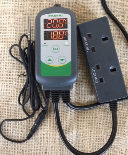

I don't have any pictures of the damage to the house, but here is what went up. It was an Inkbird temperature controller. Mine was being used on my aquarium (yes it was kept absolutely bone dry), but they're also used for brewing, and that sort of thing.
My guess was a relay failed in it and overheated, as I remember hearing it click unusually loudly a night or two before it went up.
wow, never seen that before (a fire actually starting and the device being totally destroyed!) I know those Inkbirds are really popular. I have loads of smart devices with relays (not Inkbirds), one I did overload by foolishly plugging a 3kw heater into it, it didn't' set on fire though (just overheated & some magic smoke came out!)

wow, never seen that before (a fire actually starting and the device being totally destroyed!) I know those Inkbirds are really popular. I have loads of smart devices with relays (not Inkbirds), one I did overload by foolishly plugging a 3kw heater into it, it didn’t’ set on fire though (just overheated & some magic smoke came out!)
Yes they are very popular, and I've posted/searched on loads of forums, can't find a single other instance of one catching on fire. It only had a 200w heater hanging off it so wasn't overloaded.
I was 🤏 this close to getting rid of the aquarium afterwards but the thing is, it could have been anything that went up. Phone charger, NAS, fridge, TV on standby, smart plugs, router, smart heating controller etc.
We trust these all things but it only takes a small component to fail or a bad solder at the factory etc to cause a fire down the line.
