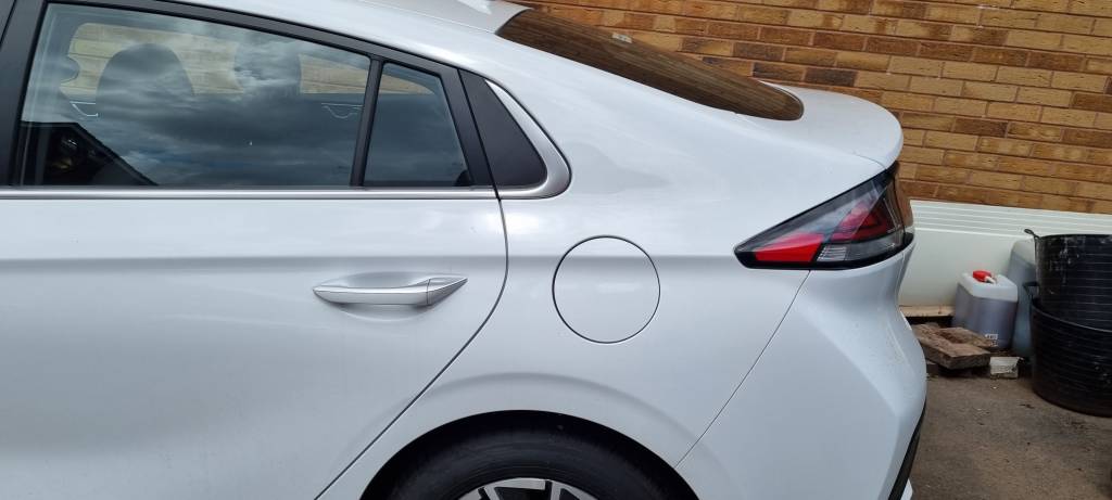

There's massive confusion as to what my paint code and name actually is, because apparently Hyundai have used the same code with different names for both car model AND model year (WTAF?).  In any case, I bought a can from Halfords and whilst I'm really pleased with the finish of the result it's a slightly different colour, a few hours after spraying.  Slightly more ivory, in fact.  So a couple of questions:
  1. Is it going to lighten up?
  2. Will lacquering it alter the shade?
It's not out by much.

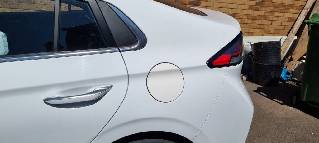

White is quite hard to match from spray cans.
Posted : 06/07/2023 2:34 pm
I know the actual paint code, but it's not on the Halfords paint can, just the name.  Which might make it hard since when I search for the paint code sometimes I get either name, and vice versa.  Basically, who knows what'll arrive?
I wonder if it's close enough so the lease company won't notice...
Posted : 06/07/2023 2:36 pm
I wonder if it’s close enough so the lease company won’t notice…
I would be surprised - they know what they are looking for and how to find it. You'll just have to hope the inspector is in a good mood on the day I think.
Posted : 06/07/2023 2:44 pm
Posts: 711
Molegrips you need to get yourself to an automotive paint company most can mix paint into a rattle car. Most big towns or city's should have one. Should be better quality than halfords and they should recognise the paint code and have a swatch that they can hold upto the car to confirm it is the right colour before the mix it.
tillydog reacted
Posts: 11486
Agree with above, just order a can from someone who will mix it up to the paint code.

EDIT based on the above I called a trade place anyway and they do mix for DIYers. Ordered some.
Posted : 06/07/2023 3:12 pm
Posts: 13916
Based on the above picture - even Mr Magoo would spot the difference!
Posted : 06/07/2023 3:34 pm
My neighbour said 'oh, no-one will notice' but I couldn't let it go like that!
The stuff from Coatings Direct was £15 for a spray can, and looks like the right colour.  Dunno about ultimate quality but it goes on easier than the Halfords stuff and seems to be gelling for a smoother finish.  Not that Halfords was bad, tbh.
Posted : 06/07/2023 4:20 pm

I wouldn't call that a close match!
Posted : 06/07/2023 4:30 pm
Yeah that picture is the previous 'ceramic white' from Halfords which may or may not have been an attempt at code WAW.
New colour is drying in the garage now.  I'll update later 🙂

Well, I put far too much on. The whole lot went soft and the new paint didn't stick to the old paint. I removed it all in a big gloopy mess with a scraper and started again, this time with primer. And thin layers.

That's gonna have to do. Still pretty obvious tbh.
At least now I know just the flap can be replaced not the whole housing, which means I can get ne from a petrol car off eBay and they are cheap.

Halfords paint match is notoriously poor.
I used rapid paints two pack rattle can for a white T5 and it was perfect.

A decent local paint supplier is really worth it for this kind of thing. They can use a specrophotometer to match.
Posted : 07/07/2023 9:23 pm
These guys did it off the paint code.
Posted : 07/07/2023 9:31 pm
Posts: 1005
Paint code will give you the correct colour if not the same name. Problem will be batch and or manufacturer of the paint. There's always a risk no matter the colour, but white is notoriously difficult to match.
We supply jlr all sorts of different parts in their colour palette, I've never seen a white car built with all the panels the same colour, unless it's sprayed all in one go. Then there's the tinted clearcoat used for Ostuni white....

Someone snapped the charging flap off. I had to glue it back on.  The replacement part new online was £250, maybe more at the dealer.  The lease car would have taken it there and charged me at least £300.  If they'd seen it without paint they would certainly have charged me for a replacement anyway.
I was going to make up a long story of woe fuelled by optimism and self belief to entertain you all but you've pushed me now so you're not getting it. You get the boring reality which now looks like this:
Total cost of 2 cans of paint and a flap from a petrol car I was able to fit: £60. So I think that's a good result.

The bumper doesn't match the rear quarter,  what else has happened?!
Posted : 10/07/2023 7:18 pm
Posts: 3315
Good result
Posted : 10/07/2023 7:31 pm
The bumper doesn’t match the rear quarter,  what else has happened?!
Nothing that I know about!!  I think that's just the light.
The replacement flap is an ever so slightly different colour - but it is from a 2016 car I believe so that much older.  But that really is close enough, for sure 🙂
