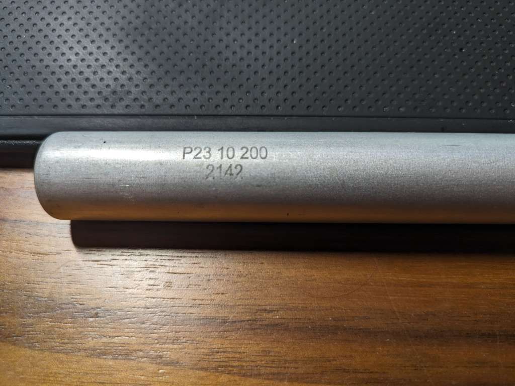

Update 1
On closer inspection. The cartridge has a part number etched on the main body. See pics.
P23 10 200
2142
But googling around this reveals nothing.

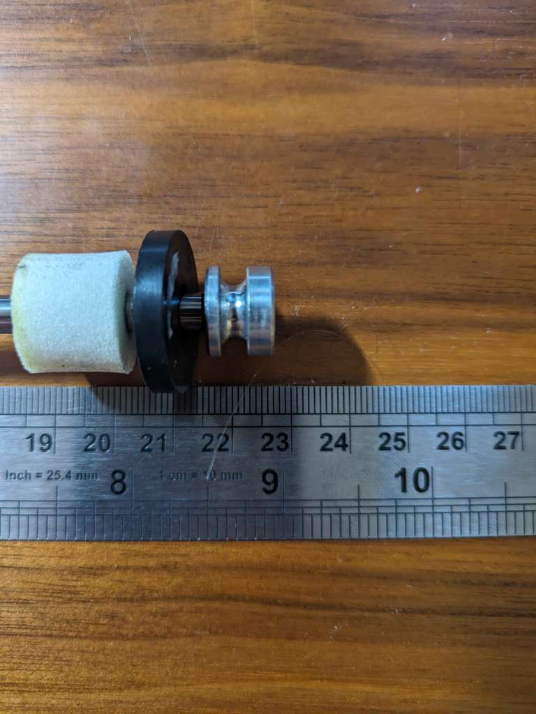

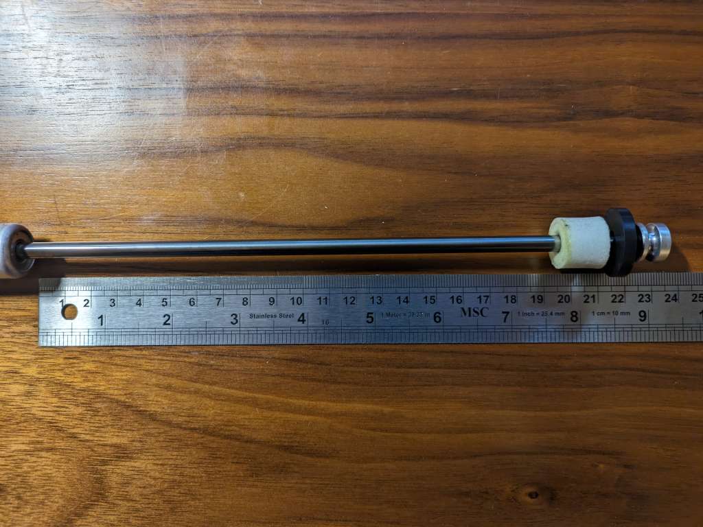

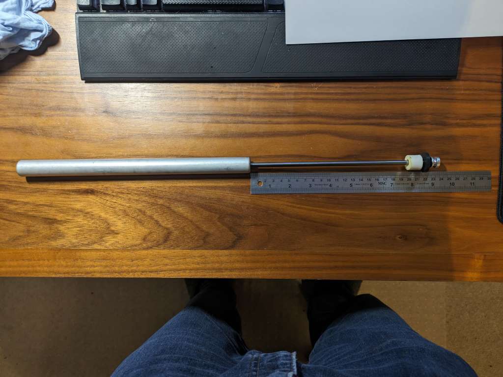

Update 2
Following a hunch based on something that's worked on other droppers. I cycled the cartridge lots of times (~50) in an inverted position, and the sag has improved (not gone completely).
I understand that on other posts, if the saddle is pulled out with the post depressed, then oil can leak the wrong side of a seal inside which then causes sag. This appears to be similar here. @patriot_matt and @munrobiker and others it may be worth a try.
I'll re-install and try on a ride to see if it holds up. If guess if it's all still intact inside then it might be OK.
