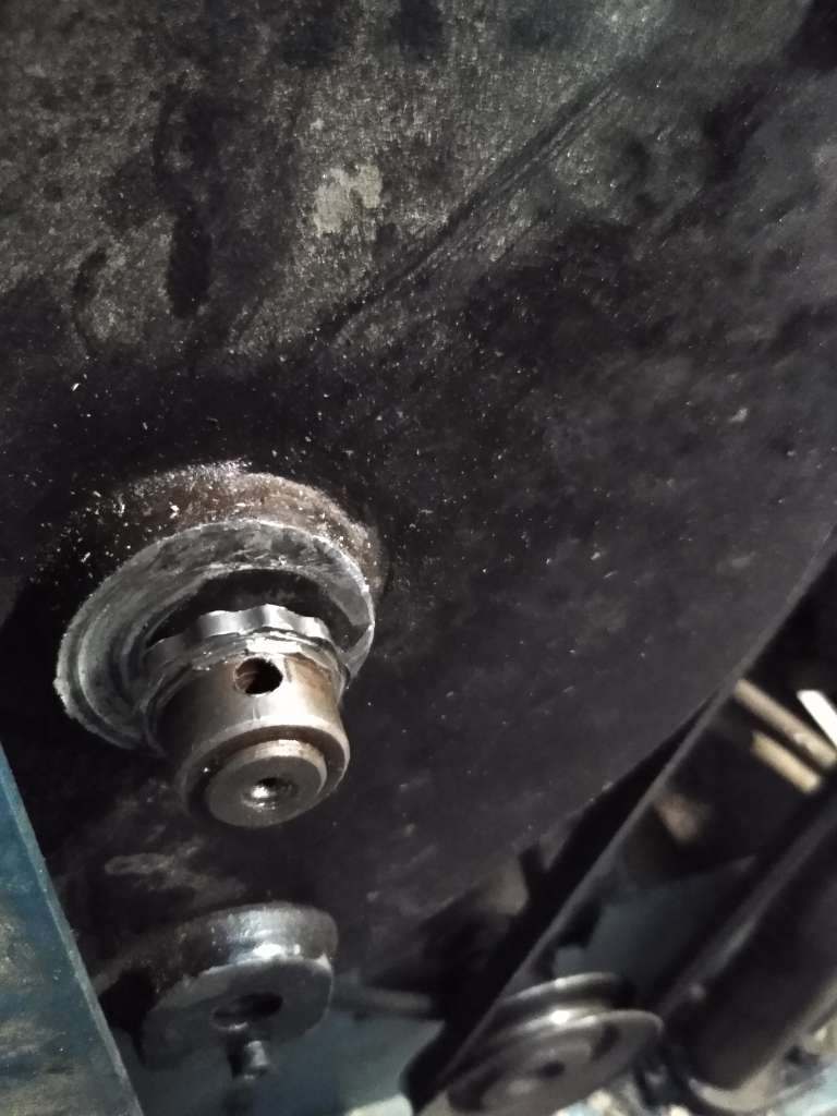

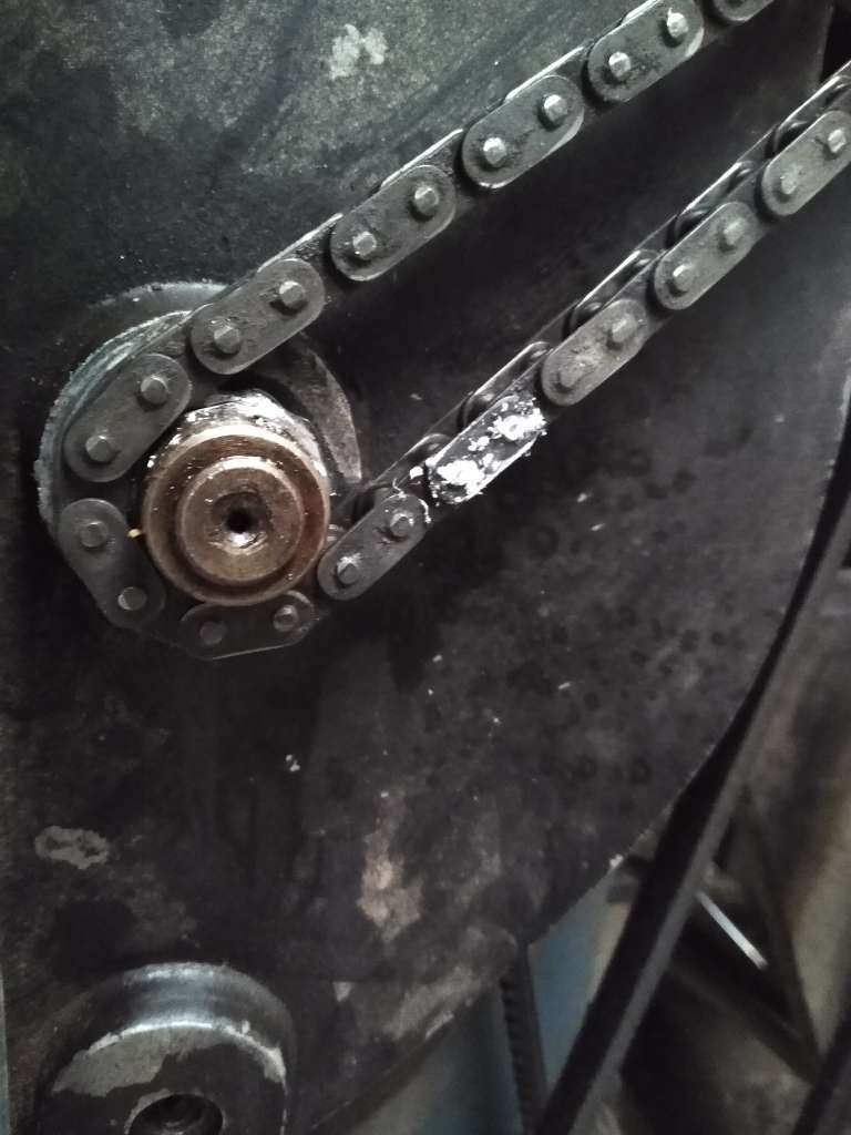

I'm trying to source a replacement chainwheel for an old (probably 1980s) Swedish woodworking machine. I've approached the manufacturers in Sweden but they aren't really the same company they were in the 80s/90s so while I wait for a response I thought surely someone on here would have a UK source for this kind of thing. Being a Swedish machine, if it's like others it's likely to be a fairly standard metric dimension part, possibly off the shelf somewhere.
The overall diameter is no more than 45mm (inc. chain), the main body is 17mm diameter, slimming to 15mm. Total depth is 45mm with the chain running on the first 25mm. The chain itself is 18mm links with pins at 14mm centres as best I can measure without disassembly. The whole thing is held on with a small hex bolt. Where can I get such a thing? Someone on here must surely know just the place & any help will be much appreciated.
Lovely phone pic for anyone interested...
IMG_20231108_094913785

Posts: 728
Can we have some more pics?
Of course you can...
[Edit, or you will if I can upload some]
IMG_20231108_155944167
Posted : 08/11/2023 4:58 pm
Posts: 728
So that top hole is the non threaded one, directly opposite the threaded one that the grub screw came out of.

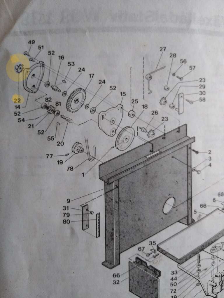

Also got my hands on a manual/exploded diagram - bit in question is highlighted...IMG_20231108_155620072~2

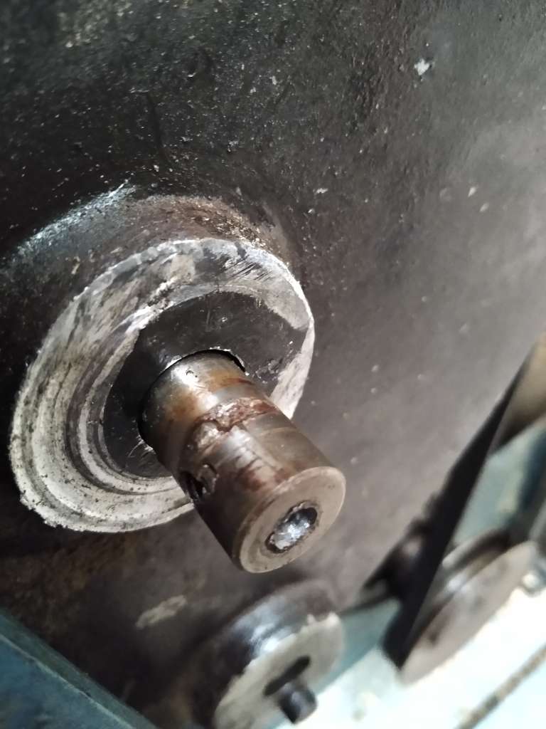

Little bit more heat and eventually forced it off. Grub screw had been over tightened on but should file back the mess and once I find a suitable replacement that should fit ok I hope. Thanks for the help so far...IMG_20231109_143204476
