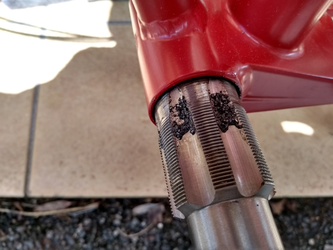

In a bit of a quandary. I took my new frame in to the nice guys at the local independent bike shop to have the BB threads chased-through pre-build. Standard practice.
Seems the sides were slightly out of line and they've stripped the non-drive side...
They can get a BB which screws together, but they're expensive (my cost implied) and I've a new one at home that is now not needed. And a new frame that is now permanently damaged (although potentially was a QC fail at the factory? Who knows)
I don't wish to fall out with the shop, but what do I do?
Ta

This is what they (should) have liability insurance for. I’d be well peaved and would want the frame replacing.
Some half-cock bottom bracket is going to cost you more whilever you own the frame.
Posted : 13/04/2024 6:06 pm
Posts: 6980
They ****ed it, they fix it. There were already threads cut into the frame, so it’s been proven that it can be done.
I’m struggling to get my head around how they’ve managed to strip threads when they were supposed to be cutting them

All may not be lost, I've salvaged BB threads that others (including manufacturers) have ****ed with a pair of these:
Clean out any bits off sticking out tube that may get in the way with a grinder. Check the faces are perpendicular and parallel, and correct with a file. Then insert the tool and proceed slowly and carefully checking with a set square as you go.
I there's not enough metal left add braze which obviously will end up with a partial repaint.
But if it's new and they've ****ed it they should replace it.

Depending on the amount & type of material around the bb shell they might be able to ream & sleeve it.
Scroll down to thread repairs.
https://argoscycles.com/resprays-refurb/price-lists/

Tarauds de boiter de pédalier Eldi. 😉
Which I Googled and got this:
https://hollandbikeshop.com/en-gb/bicycle-tools-maintenance/bicycle-tools/tap-tools/eldi-e2307-01-bottom-bracket-tap-1-3-8-24-right-gray-774983/
The pair are probably more than our OP's frame cost.
Posted : 13/04/2024 8:37 pm
Poopscoop and Poopscoop reacted
 Aidy
Posts: 2941
I'm trying to work out how they're better than a normal tap set. Does the extended section centre it better in the shell?
Posted : 13/04/2024 8:40 pm

Is that tool not exactly what the shop used in the first place?
Posted : 13/04/2024 8:45 pm

Do they not have a BB tap tool? If you're in or around Exeter then I know at least one place that can help.
Posted : 13/04/2024 8:53 pm
Given it's a a taper tap . It should be - if they were following machining principals
Often though the shop will be too cheap to buy a taper tap set and will buy a considerably cheaper thread chaser  which doesn't have the lead in of a taper tap -which is fine for 90% of these kinds of jobs a shop will see - it's meant for cleaning out swarf/corrosion/paint /nipped threads in a good thread form. If the threads misformed high chance you'll only make it worse with a chaser
Posted : 13/04/2024 8:55 pm
Yes.
Surely they are shipped ready to be built?
Some manufacturers send out perfect frames and some do not. I've never had to reach for taps when building up Look, Specialised, Giant, Lapierre... But some manufacturers send out frames that require work before they can be built up. And some manufacturers build up complete bikes with cross-threaded BBs among other horrors. The latest I've put right was a Brompton of my own. When I came to replace the BB I took the plastic cupped BB out (with difficulty) and found the aluminium-cupped BBUN72 wouldn't go in because the drive side thread wasn't in line. The above tool allowed me to correct it.
I had a policy of if it was fixable I fixed it before sale and only sent stuff back to distributors/manufacturers if it obviously wasn't going to be fixable or the fix would degrade the product. It was easier, cheaper and faster than sending stuff back.
In the case of the OPs frame it could have been Nukeproof who cut duff threads or the lbs that buggered perfectly good threads trying to chase them.
Posted : 13/04/2024 8:56 pm

Yes I always have BBs chased through on new frames as a precaution to problems down the line with poor alignment...and seems to have caught me out at the start which is a first for me. Usually have them faced too but on this occasion it wasn't needed.
I'm not naming the shop as I genuinely believe this to be poor thread alignment and a frame made of chod. They have been apologetic and generally deal with high end kit and elite riders, so isn't from lack of experience. Doesn't give me much confidence in the rest of the frame though...
I don't think I want another Nukeproof even if one was available, so the option is a praxis or equivalent BB, or try and find another Enduro frame that will fit the shock and the pile of new parts I've accumulated...
I'll know more in the week, but does look like I'll be riding on the old bike tomorrow (thank goodness I've still got it!)

An example of a badly alligned thread it was impossible to screw a metal-cupped BBUN72 into:
I reckoned it could be corrected with the above tap without loss of strength so did so, it's fine now.
Without too much loss of metal.

You are owed a frame but it's impossible to say who did the damage. In a normal situation the shop would point you in the direction of pursuing a warranty, but it doesn't sound like this in an option.
The thing is.....if a bottom bracket is in perfect condition, I don't know how a BB chasing tool can wreck a frame due to the way the tool locks together.  They are pretty idiot proof unless one puts the tool in the wrong way around! Some are not labelled so you have to look carefully at the threads (which is really dumb). The tool is also only really designed to clean the threads and get rid of small imperfections, not magically make a wrecked BB shell perfect again.
So if the frame was dead from the factory, the tool could potentially make it more dead than a Monty Python Parrot. Which sucks for the shop who innocently took on the job. Maybe the mechanic was too gung-ho and thought by forcing the tool, it would make everything right. Doesn't change the fact that the frame was probably faulty and not fit for use in the first place.
I'd be going after 'Nukeproof' more than the shop but I'm guessing that you can't.

Why force the cut when meeting resistance. Always go slow at first when chasing threads.

People seem very keen to blame the shop rather than Nuke proof. BB shells are cast, pressed or machined then brazed into the frame. That's when the first errors occur:
Check whether you chainrings are perfectly parallel to the top, down and seat tubes. Some of you may be disappointed, some may be so bad you realise you're pedalling at an angle and your chain line is shit.
Next the frame builder puts the frame on a flat surface and starts measuring and finds something isn't right. So they start "cold setting" which just means hauling on the thing to get everything in line and where it should be. During this exercise the weakest points yield, sometimes that's the BB shell which means the shell is no longer a tube with parallel walls.

Posts: 18073
Fool proof. Have a look a the photo of the red frame I posted a page back. That's quite a well-known manufacturer that makes thousands of frames but it's clear in the photo they had two goes on the non-drive side. A first go where they got about 5 turns which was significantly out of line then a second go. It cleaned up fine. On the (other) drive side they'd done it in one go but it was slightly out of  line, again it cleaned up fine. I don't know how the manufacturer screwed up but they did so the operation isn't fool proof.
