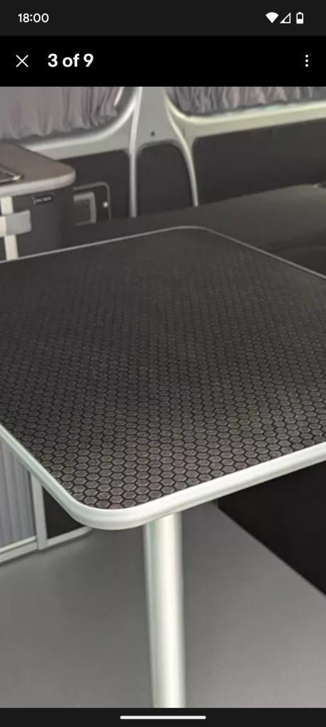

I'm making a table for my van and want to stick some vinyl stuff on it so it's non slip(ish). Does any one know what this sort of stuff is called or recommend anything else? My Google foo is failing me at the moment...

Look up phenolic ply. Probably made with that.
Posted : 28/01/2025 6:07 pm
Not so sure you can buy it as a stick on, comes as phenolic ply wood which is pre applied pvc stuff.

It's Wisa Hexa, available from Lathams.

3m Dinoc might have something as well but, again, not cheap.  Good laminates rarely are.

so it’s non slip(ish).
Phenolic is  super slippy. It's intended as flooring and the hex pattern gives a little bit of grip to something like a shoe (ie something soft and rubbery) . But the phenolic resin is very hard and very slick and the texture just mean other hard objects have barely any points of contact  so most things just slide about on it
(I have lots of offcuts of it and had a notion to make a sort of airhockey table out of them because the phonolic slide across other bits of phenolic so well)
If you want to apply something non slip to an existing surface then you maybe want something like textured rubber flooring

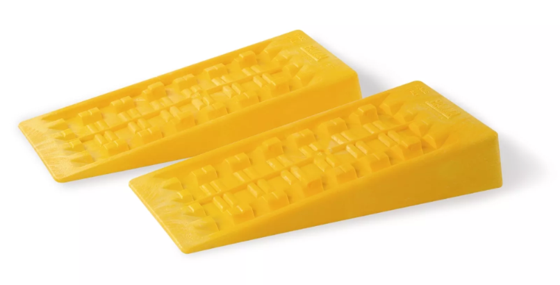

Maybe worth considering?

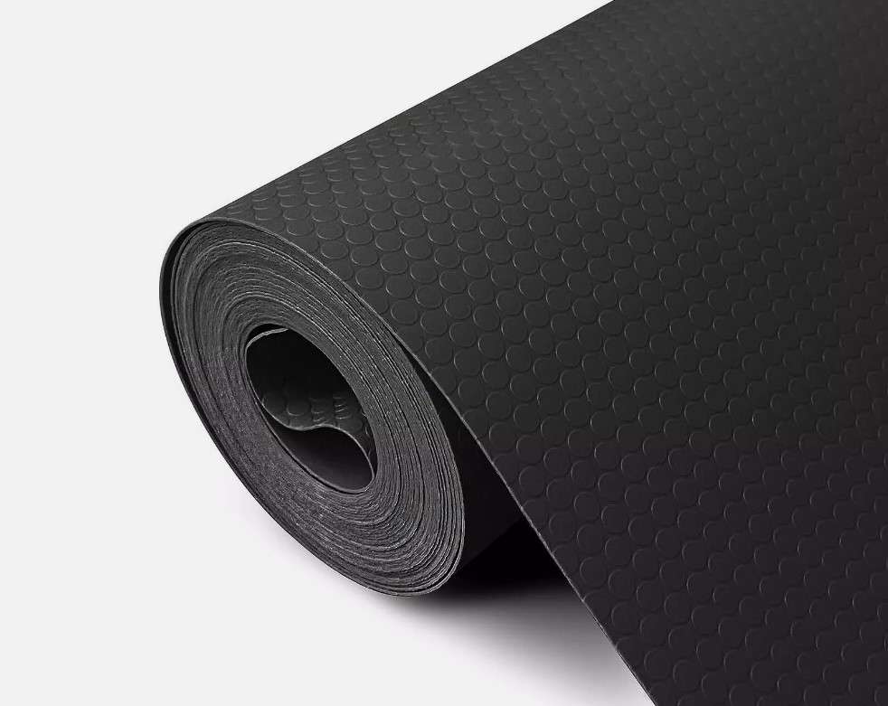

Thanks all. Yeah I'm not bothered about it being slippy or grippy when stationary, and I am bothered about being able to clean it though so originally discounted the drawer liner stuff with holes in it.

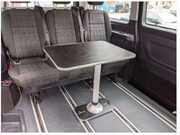

Basically its a table that will bolt into the floor rails and be in use while moving, whilst i'm not expecting people to be able to balance wine glasses on it while I'm driving round the nurburgring, it'd be nice for the kids to be able to place something on it (phone or power bank or something...) and it not be sliding all over the place. The table top will have cup holders set into it so they can shove a can or bottle in there. I don't think we'll be eating dinner off it regularly, but wipe clean would be nice.
I'm going to give this stuff below on ebay a go and see how it goes. I've got most of the bits to build it already laying around in the garage, just need the cup holders £6.50 for 2 on ebay and some non slip stuff if possible.

Its based on this one I saw whilst googling...

I’m going to give this stuff below on ebay a go and see how it goes.
This does not go with this:
I don’t think we’ll be eating dinner off it regularly, but wipe clean would be nice.
Personally I think it will not live up to your expectations - there's a reason why tables are [probably] always smooth.
...... or their phones/powerbank, etc.  I'd start with this and then add the non-slip stuff afterwards if you really feel the need.
