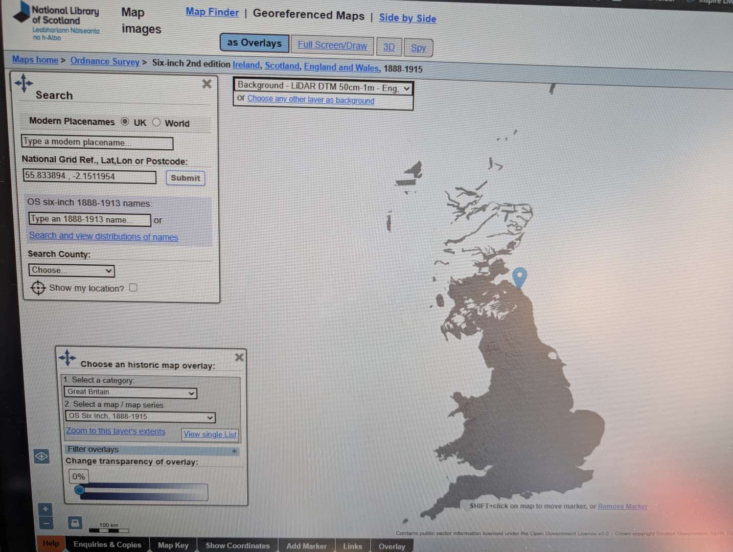

Posts: 1617
Please forgive the literal screenshot
Posted : 21/05/2025 3:55 pm
 Yak
Posts: 6920
Wales fully done then? The OP's original question included the Welshpool area.

Jamiemcf. Its being done in phases in Scotland. Not sure the NLS map is fully up to date. The data is freely available from the Scottish remote sensing portal. Or in england throigh he defra site.
Quick install of QGIS and anyone can have a play.
Posted : 21/05/2025 4:31 pm

Posts: 1617
Thanks Josh. It's just a layer on that map that I never use. I was actually using the 1915 map locating culverts.
Posted : 21/05/2025 6:04 pm
