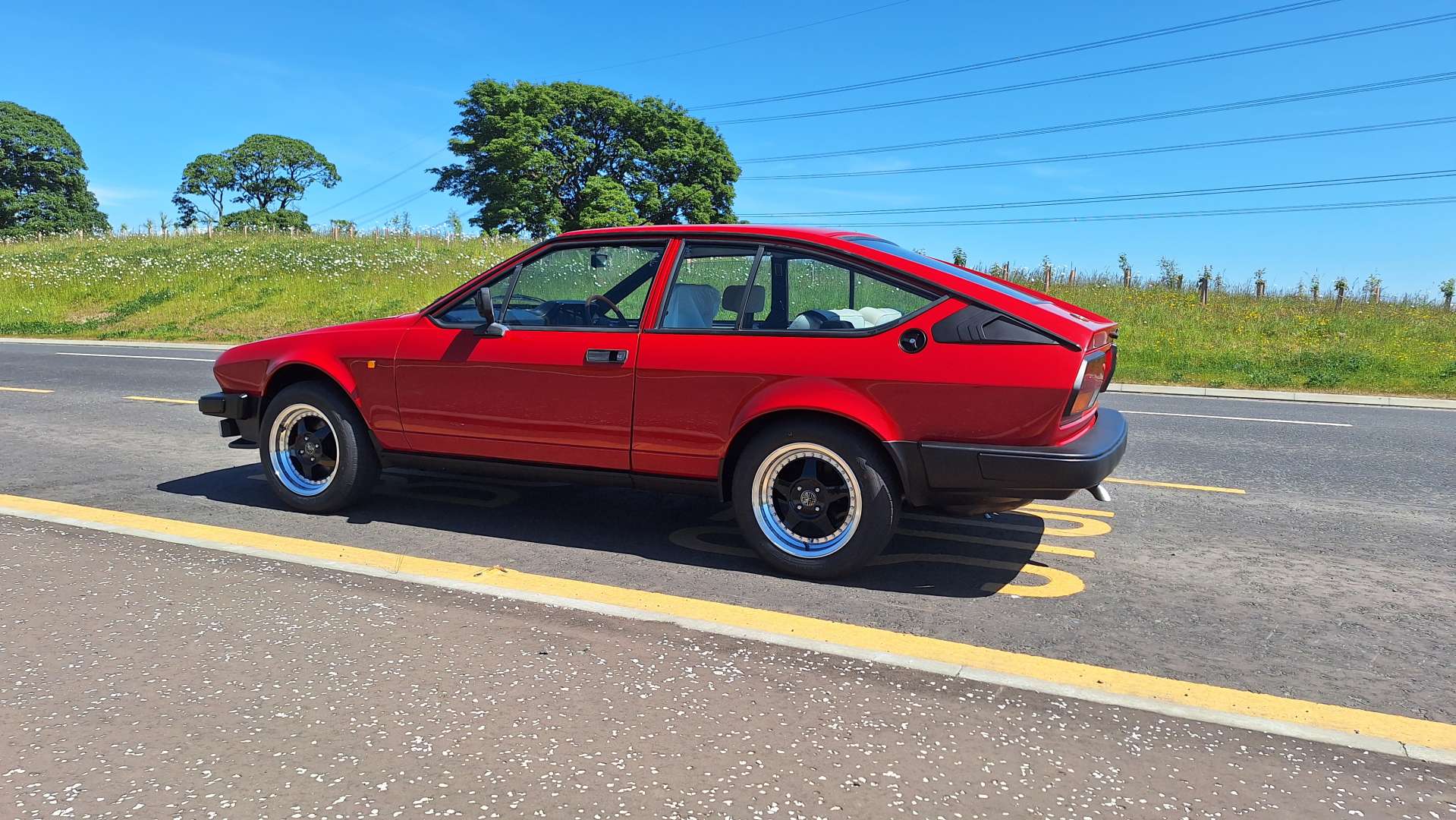

Latest installment of a long term 'repair' project. Did some test runs on my GTV after gearbox rebuild and many other bits and bobs. Here it is with its new wheels on a rare sunny Scottish day.

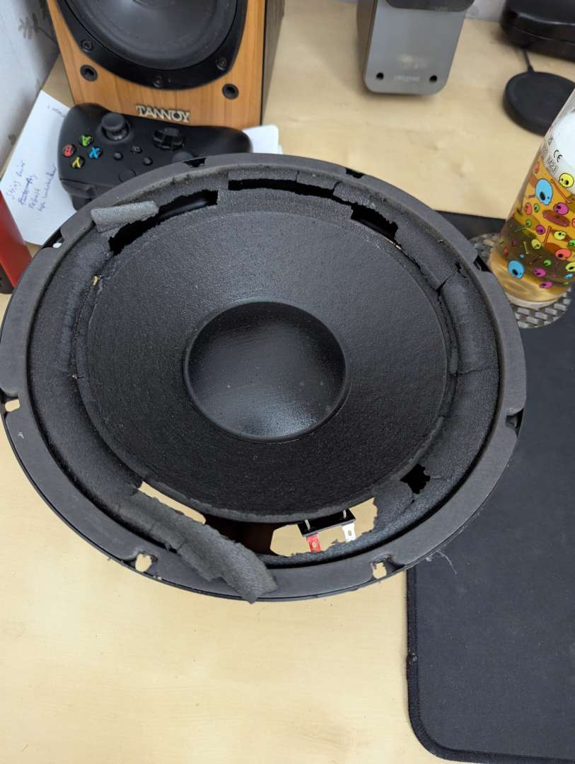

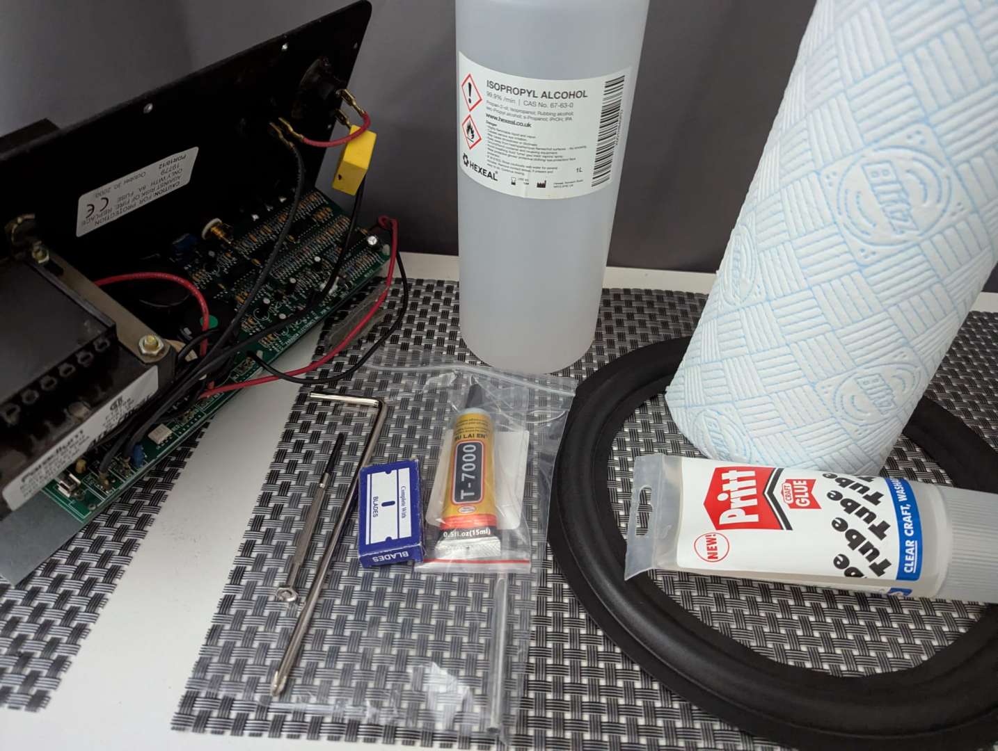

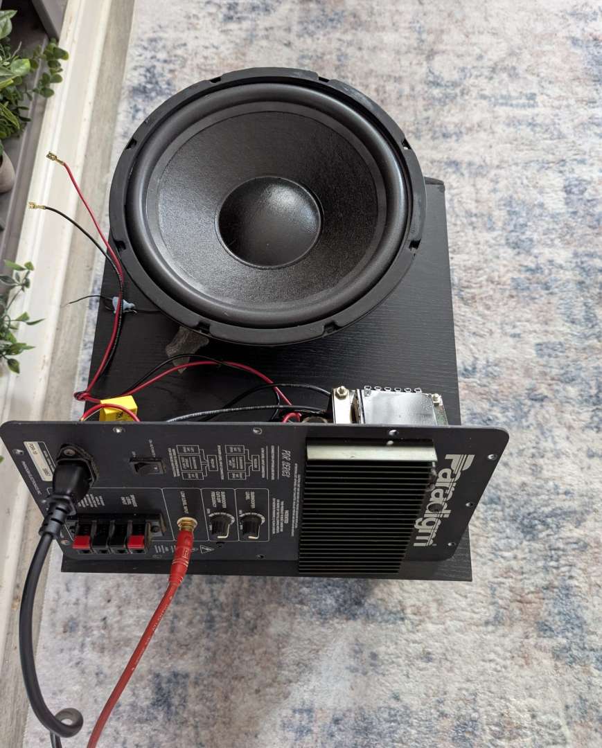

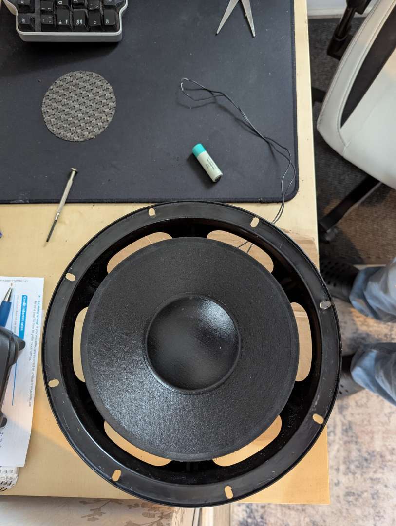

So my active sub started making a weird farting noise and had no volume.
The cause of the issue soon became apparent!! 🤣 to be fair I've owned it 25yrs and the foam suspension has simply perished by the looks of it.
A quick look on the internets and and my reaction to the prices of new 10" active subs was "ooow blooody much!?!?!"
It then dawned on me I could just swap out the driver for a new one, but that brings its own headache, as the amp and speaker are made in-house by Paradigm in Canada, a lifetime ago with unknown specs other than 100w, 10", so pairing a new speaker to the box and amp might require a bit of guess work. I supose I could have contacted tem to see if they had any detailed tech-specs buried in a filling cabinate somewhere, but, meh..
Enter the £10 repair kit! includes two new surrounds, some special glue and a brush. Well actually £15 as I had to buy an additional tube of the correct glue.. the 15ml supplied was a bit of a stretch for a 10" speaker.
Watched a few youtube vids to get the jist of what's involved and variations of technique people use. Who would have thought there were so many hi-fi nerds doing speaker refurb videos? 🤣
Slight hiccup in that the gasket is some sort of paper/card laminate, and I mangled it slightly removing it, so a bit of generic hobby glue gently massaged into it, & clamped down took care of that.
All the caps on the amp look good so I've not touched that.
Good as new for £15... 😎

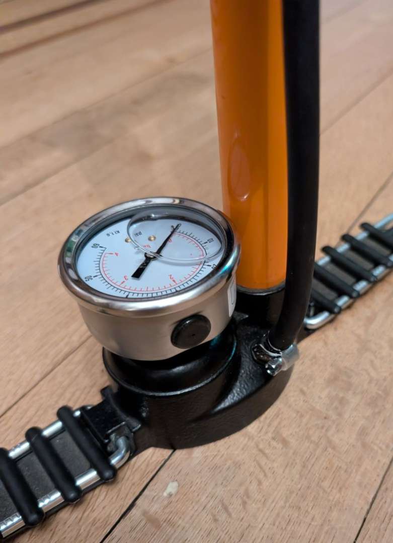

Ancient car footpump that was my dads, decent quality with an accurate gauge.
The hose punctured at a crimped joint, worn through by the metal collar, new hose was more expensive than an ECP foot pump.
Hacksaw all around the collar reveals a barbed fitting into the hose, chop the hose above the hole, push onto the barbed fitting, jubilee clip, job done. I'll put a spring clip on when I get one

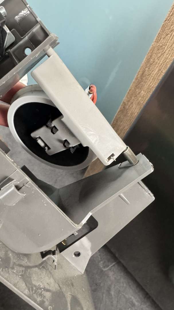

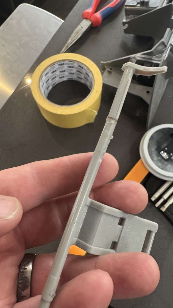

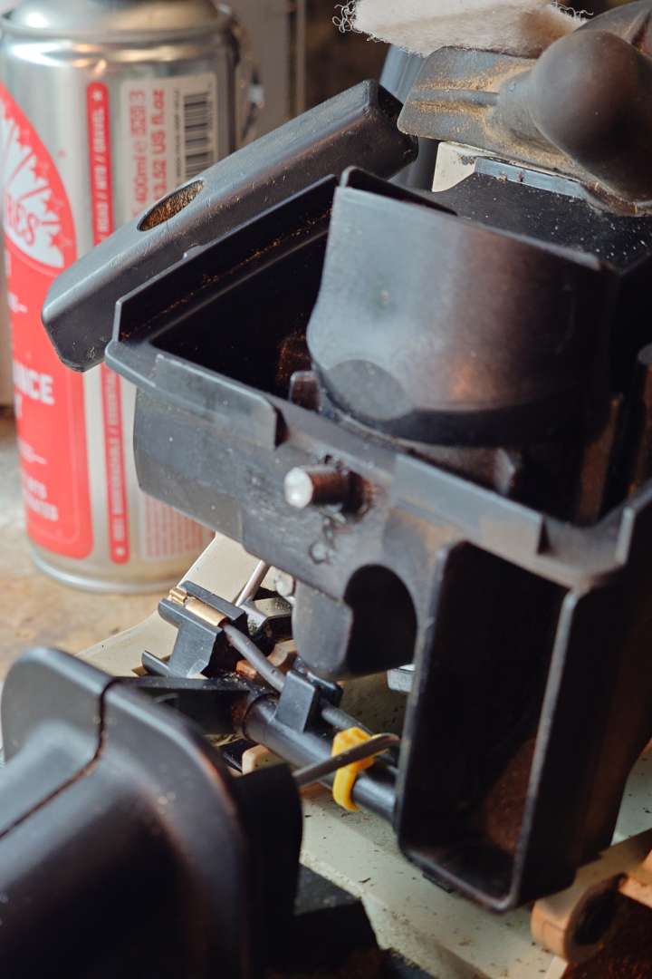

Flappy door on the fridge that allows ice to be dispensed has been broken for a few months. Took the door apart today and found there’s an almost Victorian mechanism in there. It connects the flap to a large solenoid via some shoddy plastic axle that had simply sheared in two.
Drilled both parts of the axle, cut an old spoke down to size to act as some internal reinforcement, then glued it all together with some epoxy. All working fine. Just as well as you can’t get parts any more for the fridge.

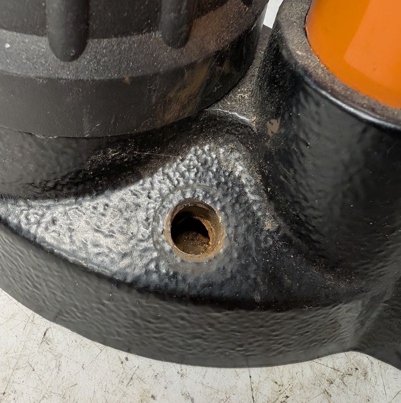

Repaired the hose attachment on my SKS rennkompressor. Threads had gone so drilled out, tapped and fitted a m10x1.5 to 6mm barb. Also finally fitted the larger dial and lower pressure gauge I bought ages ago.

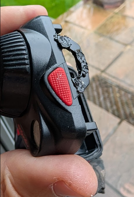

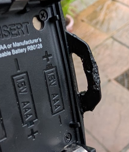

The clasp that holds the battery compartment shut on my head torch has been getting weaker and weaker.  Last night one half off it snapped off completely.
Youtube has been presenting me with vids about using a soldering iron and cable ties for plastic-welding, so thought I'd give it a go.  It's not the prettiest, but feels fairly strong.  I was a bit rushed before work when doing it this morning, I might try and tidy it up a little over the weekend.

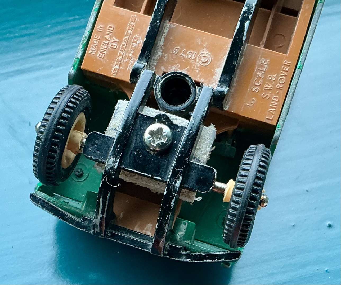

A very old toy donated to us, all the plastic holding the front axle in place had broken and disappeared. I used a small piece of Ikea chopping board with a groove to hold the axle and a self tapper to hold it in.
Ikea chopping boards are a resource that no workshop should be without, easy to saw, slightly flexible and also takes a screw. I’ve used them for kitchen drawer sliders, door catches and stopping adjustable tow bar rattles - amongst others!

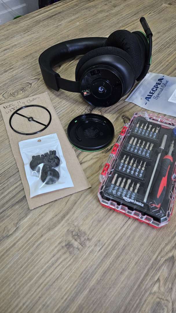

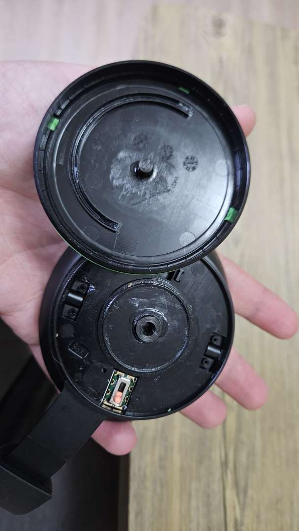

Just fixed a broken volume dial which my daughter snapped of a set Xbox wireless headphones.
Big thanks to @stumpy01 for the 3D printed parts 🤗
Photos are in the reverse order but I'm posting with my phone.
