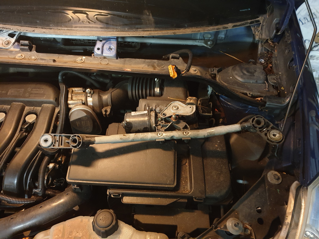

Just this evening helped my daughter replace the wiper motor in her aging clio. And un-bung the drain holes which meant it had been sitting in a trough of water.
AA man had told her it would cost £300 at a garage. £25 for a new motor, sorted.
Only tricky bit was getting the leverage bits in the right place so the wipers went up not down. Which we only realised once we'd reassembled all the plastic covers etc doh!
Posted : 05/10/2021 10:46 pm
