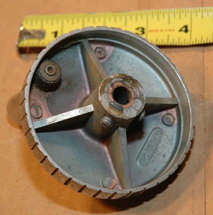

 JoeG
Was it a handwheel like this?
If so, a key fits into the slot in the wheel and engages the flat on the shaft. [url= https://en.wikipedia.org/wiki/Key_%28engineering%29 ]https://en.wikipedia.org/wiki/Key_%28engineering%29[/url]
If its a low torque application, a set screw could also be run through the wheel to engage the flat on the shaft.
