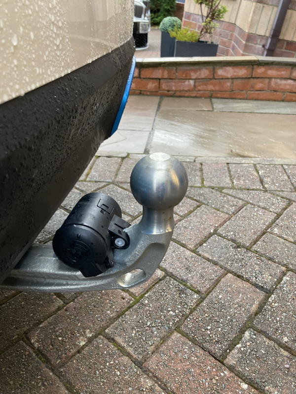

Posts: 17187
Tho I am puzzled on another weekend  thread about Atera racks that people are having to use shims to provide enough friction on the tow ball to keep the rack horizontal.
that’s my thread, and it’s more about stopping it moving in the horizontal plane. It is rock solid vertically. Some modern towballs do not accommodate Thule and Yakima racks due to the short depth of the ball, so choice is limited.
Im my case, I had to go factory towball option therefore limitations on rack choice. I’d have preferred a Thule, but it doesn’t fit.….
