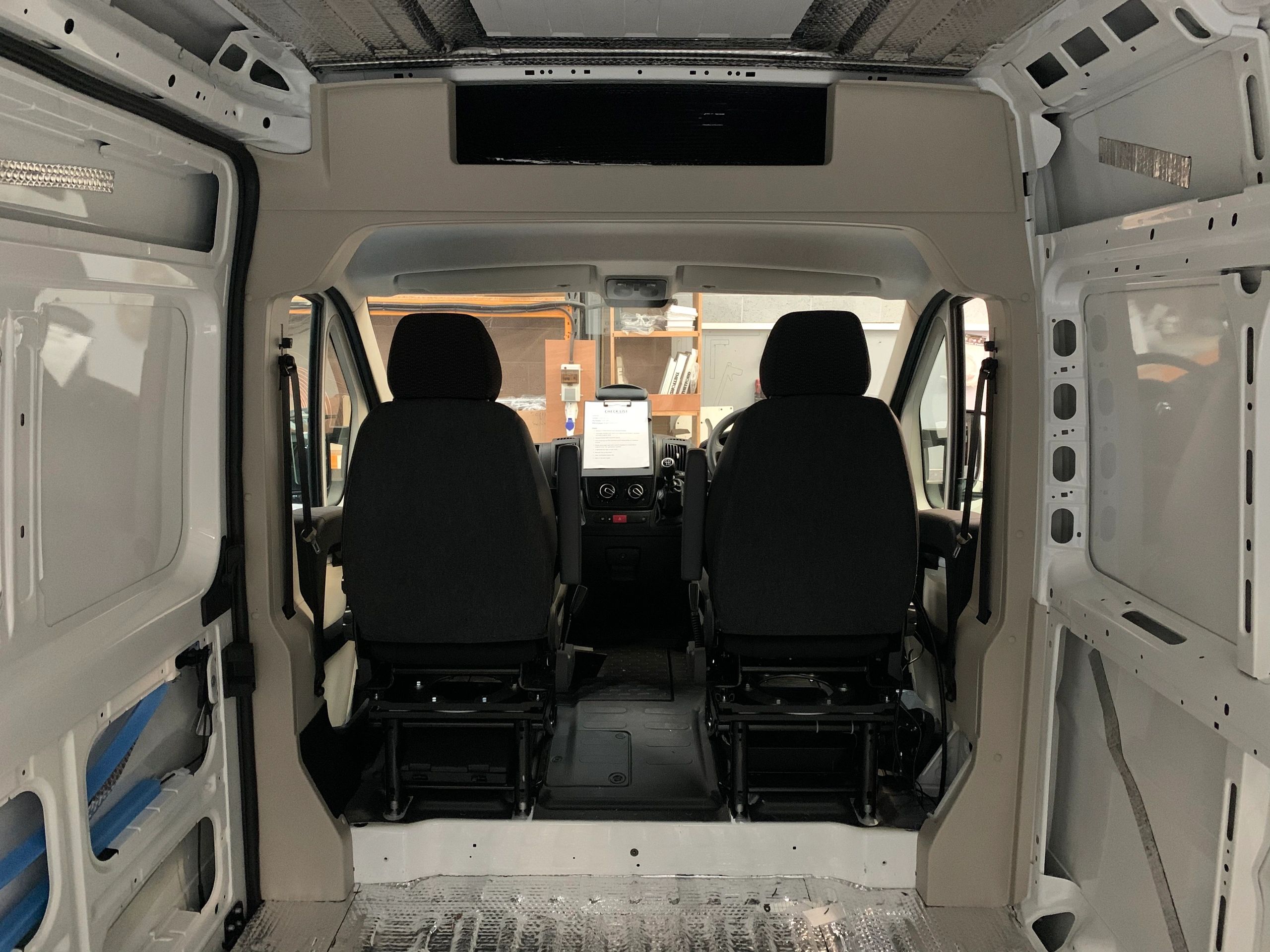

Part of my new van plan involves a modified bulkhead. I can explain it if you're bored.
Basically, it's a right bugger to cut! An angle grinder and 4 cutting discs just made loads of noise, smoke and an ugly, straight edged hole in the middle.
That's fine for now but I'll need to finish it with a lot more accuracy and hopefully without going deaf or setting myself on fire.
Perfect excuse to go tool shopping. What's best for carefully following a marked line in a steel panel with lots of curves? Jigsaw? Nibblers? Can't really justify a plasma cutter.
