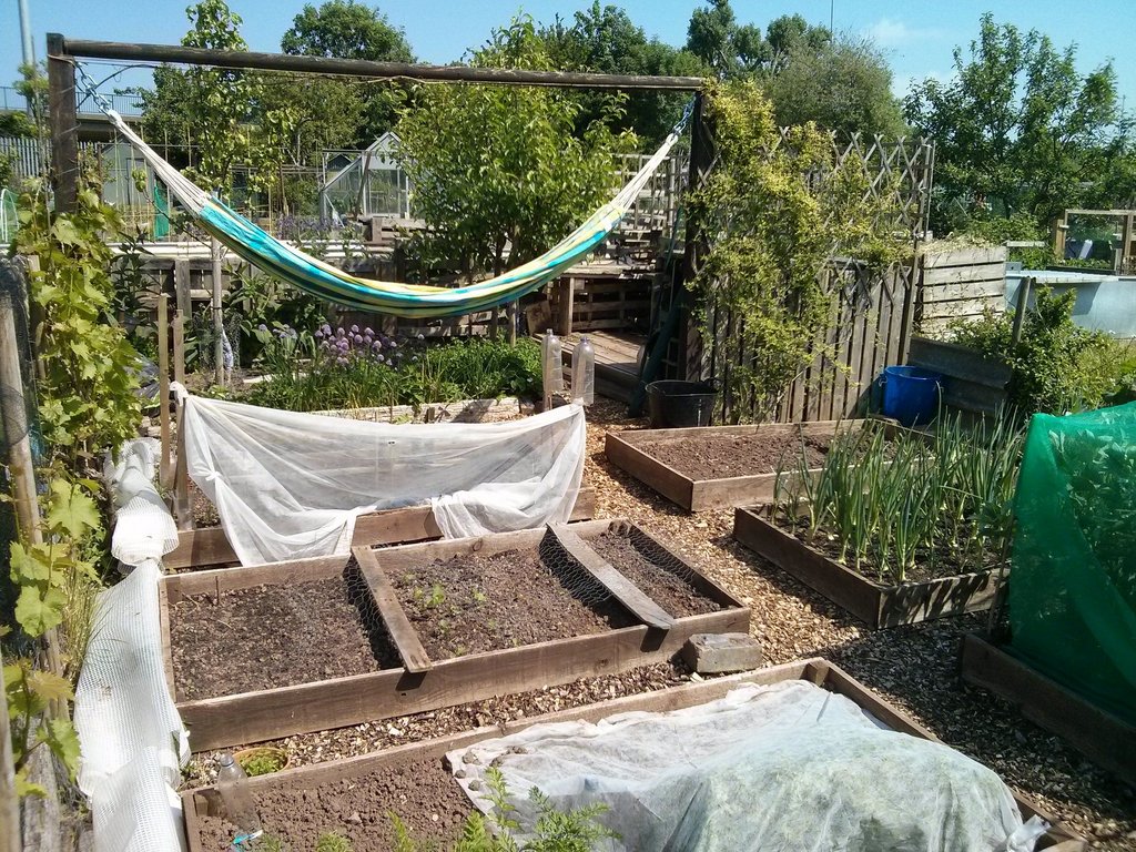

Posts: 683
I used two 3m long 100mm posts when I did mine on the allotment. About 1 metre of the posts sunk into the ground, and a 75mm round pole in between them at the top to counter any flexing inwards and of course for the grape vines to grow along.
hammock
