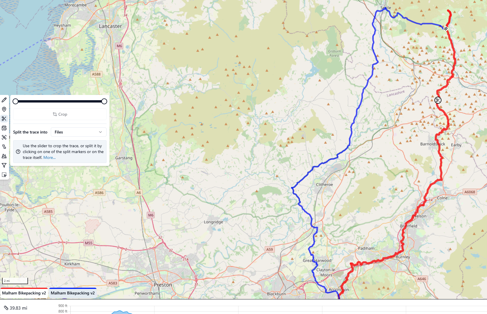

2nd'd , but i also use gpx.studio for reviewing and fine tuning the routes. Its track editing capabilities are the best I've come across. it also allows you to display several gpx's on one may and colour code them - handy for multi day routes

Thank you to everyone for the suggestions and advice - super helpful. Here's what I did:
- downloaded GPX files for the EuroVelo and other routes I am intending to follow
- Loaded them all into gpx.studio (HT @slackboy) which allowed me to edit out the bits I don't need, and merge them into a single route
- Split them into chunks of 100-200km, and extract each one into a "Track" (as opposed to a segment, since that confuses Komoot). Gave each Track a meaningful name
- Imported each Track into Komoot which let me see elevation profile, estimated speed, etc. For reasons I don't understand, Komoot seems to have synchronised these to my Garmin despite me not being a premium subscriber.
- Imported the whole file into Google Maps (which does understand multiple Tracks in a single file), and added all the campsites I could find that are near the route
- Backed up the gpx file on google Drive
