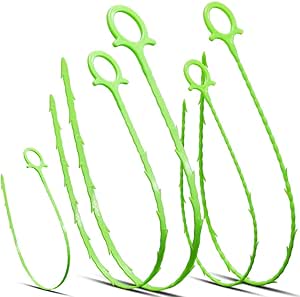

Posts: 1049
Used these things on our bath/shower plughole, Results were grim but it worked!

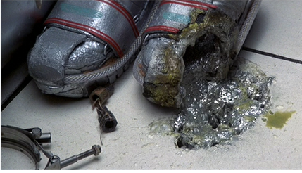

Well definitely NOT Hydrofluoric Acid... So I've heard...

Posts: 11961
Well definitely NOT Hydrofluoric Acid… So I’ve heard…
Based only on watching a tv show with extremely questionable scientific claims, hydrofluoric acid would dissolve the hair that's blocking the drain, but not the pipe if the pipe is made from the correct plastic. What's the worst that could happen?
Posted : 29/02/2024 3:31 am
Posts: 1031
I used to work on a plant with HF… Jesus that stuff scared me. Burns were apparently horrific. Once burnt through your skin and flesh, the fluoride ions would start stripping calcium out of your bones. Well before my time in the ‘good old days’ (70s) a guy apparently had a face full sprayed at high pressure from a failed gasket. Died a pretty horrific, agonising death.
Posted : 29/02/2024 5:49 am
What’s the worst that could happen?
As above, even a relatively small spill on your skin if not treated fast and with the correct antidote can be horrific and you may die. A horrible death as it strips calcium out of your system screwing up the way your electrolyte balances regulate muscle activity, leading potentially to convulsions and if that's your heart muscle, cardiac arrest and death.
Although burns are apparently very painful, they don't start on exposure, and can take minutes or hours before you realise, by which time it's now creating the systemic effects too. If you were to spill it on yourself best do a good job so you know it and can react.
Some clean rooms use it for deep etching of wafers for semiconductor and micromachining work, but many won't allow it on site. We do and with our H&S advisor, I wrote the procedure for using it which includes having a buddy in the room with you, who is equally trained on HF use so if there's even a hint of a spill, they can crack open the antidote and get it started.
TLDR...don't use HF.

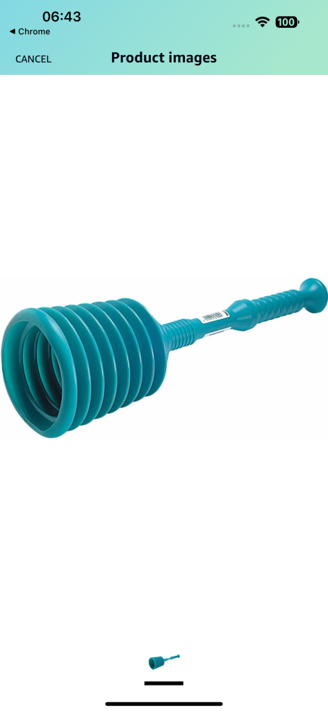

Posts: 9201
Are you messing about with a normal plunger or have you gone big? One of these unblocked the shower used by my two teenage daughters,
