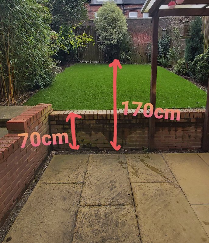

I keep staring at our back garden and feeling like it's a waste of space. We haven't touched it since we moved in and we're not going anywhere soon so I'm itching to tear into it.
At the minute it's a large square of fake grass surrounded by a very popular and highly frequented feline restroom. It doesn't look it in the pictures but it's too steep to comfortably sit on and the plastic grass makes it too slippy anyway.
My question is, how difficult would it be to excavate it by hand? Apart from the back breaking physical labour involved in moving 50 tonnes of soil to a skip, what's the chances of hitting an immovable object? What do builders use to bulk up a garden? Will it be full of bricks and rubble? Gas pipes? Unexploded ordnance? I don't mind doing the work but if it turns into a major ordeal I might rapidly lose motivation!
Anyway, this is what I'm talking about...
Ultimate goal- Bring it right down to the existing paving stones and have a huge flat square to use as I please. Potential for mega-shed at the back. Probably months of work and need some pretty hefty retaining walls on 3 sides.
Stage one- Bring it down level with the existing retaining wall to see how difficult the digging is. The wall is saturated and I can't believe it's still standing. I could do this see if I'm biting off more than I can chew. Then at least we'd have a useable flat garden for regular grass, raised beds etc.
Should I just buy a mattock and crack on? Or find something else to do like learning French or taking piano lessons?

It's most likely building rubble left over from building your house. No point in carting it away as it costs money.
Assuming you want to level it to the height of the brick wall in the foreground then you've just over 15m3 of soil/rubble to get rid off. Roughly 1.5 tonnes per m3 so about 23 tonnes. Also depending on how compact the soil is it will "expand" to about 1.5 times its current volume when dug.
However you'll likely want to remove more than that because you'll be in the midst of whatever's underneath so you need to take more out so you can put a base layer in for whatever you end up using as the surface.
You probably don't want to take all of that earth away though - the fencing will need some support so you'll likely have some sort of retaining wall around the edges which will eat into the area a bit. So if your ultimate plan is to get down to the level of the paving in the foreground then you really need to consider that.

OP you are proposing an extremely expensive task to make it one level, far less expensive to retain the patio on it's level and the second tier on another level, preferably built up rather than excavated. But still a big task when you could instead think about tiering it in to ~three flat levels without needing retaining walls. As others have said you'll need retaining walls on the public footpaths and neighbour gardens, which will probably have to eat into your garden space to ensure they have sufficient gravel backfill. It looks like you have a consistent seep of groundwater on your current 70 cm retaining wall around the second brick down. Yes it has been wet, but this winter won't be too unusual going forward. So you need to think about drainage for the retaining walls (and if you modify the front retaining wall add something better in there). If you have more than 1.2m you need toe drainage. If you genuinely have a 1 m difference in height in a 5 m garden, then the groundwater at the top footpath side if only 50 cm below ground could give quite a flow into your garden if you excavate (path of least resistance, depends on the geology).
Also if you are genuinely thinking of excavating over 1m, think about both aesthetics and how you will get sufficient light into the space. The horizontal to vertical ratio and the amount of shade for half the year when the sun hides behind the house and fences, think about how useable and enticing the space will be, both for how it feels and to avoid it becoming dark, damp and mouldy. Your going to have a 3+ m tall walls surrounding a 5-6 m wide square. I think more terracing might make the space more appealing to sit out in.

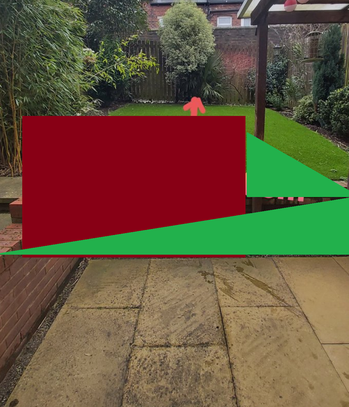

Maybe a very gradual lawn width set of steps in place of the existing wall so you'd lose lawn length but it'd be more inviting.
Third image down would give raised beds opportunity.

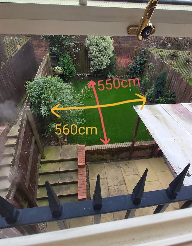

The difficulty with retaining walls is that you don't own the ground behind, so you can't let it move; you have to hold it up while you build the wall. You'll need a temporary retaining wall of some kind, so the inside face of your wall is likely to be 30-40cm into the garden. It's usual to extend the base under the soil to weight it down, but you can't, so your walls will need to be attached to a slab across the garden; all reinforced concrete. Not impossible, but a big job, not a usual DiY task and several £1K. You'll also need to go through the party wall formalities with three adjacent landowners.
You could start by digging out behind your existing wall - which would give you a good idea of what you might find. Then put in a drain at the bottom, piped to your existing rainwater drains, backfill with single size gravel, with a terram membrane to stop the soil mixing with it. Or try the same thing but rebuild the wall a bit further back.

You know what? You've all said pretty much what I imagined. It would be a gigantic, expensive, ball-ache and I don't need it. Even though I was getting used to the idea of a 5x2 metre shed with a tin roof.
I might just build some long timber panels and use them to retain the existing borders. Then I can level off the area in between and use the soil to fill up the planters.

If the rear is really 1.7m higher than the patio (that's a 1 in 5 slope - blimey!) Just whack a deck in level with the rear of your garden, access it from upstairs and use underneath as your shedofdoom

Why are there spikes directly underneath your window?
