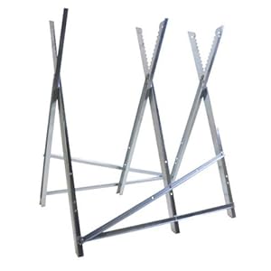

Looking at getting a saw horse as we are starting to source uncut logs for our log burner.
I need to cut logs say 4 to 2 foot long down to 12 inches, ready for splitting.
this is 25 quid from Amazon, will this do the job?
this is £30, looks to be able to grip the log better, but is the spacing too big to be able to cut 2 foot logs in half?
or is it best to go and get something like this, 50 quid
What are you using?

Knock one up from scrap wood like the Amazon job or visit an independent wood yard. For £25 you get a sturdier build than that, it looks a bit flimsy.

I've got the porchek (sp?) one the £50 job. Excellent bit of kit well worth the money. makes the whole job a lot safer and can be used by people who are otherwise not confident with a chainsaw

Piece o cake to nock one up yourself, dont buy a metal one, not good on your saw chain if you hit the steel

I made one out of pallets, the 3x2 bearers, not the 3x1 planks.
It's got loads of chunks out of it by now, where I've gone off line a bit with the chainsaw. I wouldn't use a metal one.

I have the metal one, think it's pretty good for sawing long logs, though I'm not using a chainsaw. I usually prop one set of legs aginst a step to steady it and then it's fine. I was going to make one but then saw this, seems ok, the serrated teeth grip the timber well.

after looking into the suggestions, the first yellow one does look a bit limp.
could make my own, what sort of spacing are you guys using between the legs? and what length are the finished logs you cut?
kilo / tonyplym and anyone who has used the type which hold the chain saw - have you also used the x-type horse to compare? is the log secure in the 'tray'? i like the idea of this saw horse, seems to free up a hand.

I made mine from 4x4s. Drilled each of the three scissors with a 10mm bit, bolted together with threaded rod. If possible recess the nuts and washers to saw the saw catching them. Line up the scissors, the end ones a little closer than the third to suit your log size, then nail three 3x1 length ways to join them together.
I've chopped a mountain of wood and the horse has stood outdoors for ten years.
I've only ever used the metal one in the OP. The log is secure because of either the weight of it in the tray or you can use one hand to hold it in place as the saw only needs one hand to operate it. If your hitting metal as one poster mentioned you've not put the saw in properly. I use it in an uneven stony yard or in quite a tight wood shed so it's great the saw is clamped out of the way, ticking over when i'm moving logs to cut and it folds flat. Also because it's so easy to use, the wife is happy to cut wood - obviously this leads to competitive wood cutting and ensuing rows

I made my own out of scrap wood and I made the smaller right hand space so that it was the maximum length for my wood burner. If it falls through the gap it fits in the fire if not it needs a cut.
The left side is roughly twice as wide.
