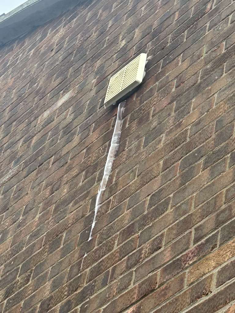

Posts: 4421
The Manrose and insulated ducting clearly work at ours, it’s 5m long and 6” diameter.   Just need to put back the vent which seems to have come dislodged…
IMG_1778
