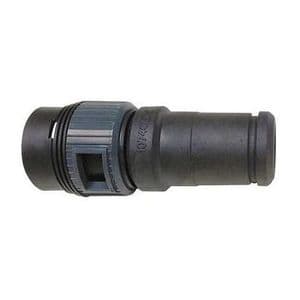

Hijack - question for Nilfisk owners... the hose end has a large plastic bit permanently attached? How do you get on with that attached to something mobile like a sander? Currently using an old, weak-sucking Dyson with a similar plastic handle that is forever falling out of my tracksaw.
Power take-off seems to be 1200w, but my mitre saw is 1300w - hmmm.
It's not permanently attached, it comes off and is replaced with a power tool adaptor which is a heavy duty rubber cone which will attach to most power tool dust outlets.
