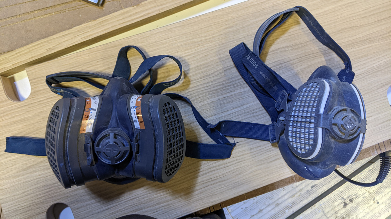

I use two Elipse masks depending on what I'm doing.
Can't comment on asbestos but I use them for dust, mdf dust inclusive and spray painting Water-borne paints.
The one on the left is A1P3 which is vapour and dust
The one on the right, P3 is dust only.
Some info on mask choice HERE
Both comfortable and judging by the reviews on Screwfix, seem to fit a variety of faces.
