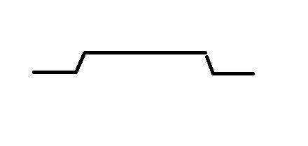

Ah right. No, the stuff I've been given is cheaper/nastier than that and a lot wider.
The profile is, um, kind of like this (Watch out Jamie)
It requires more fixings than that as the cable alone will push it out of place.
