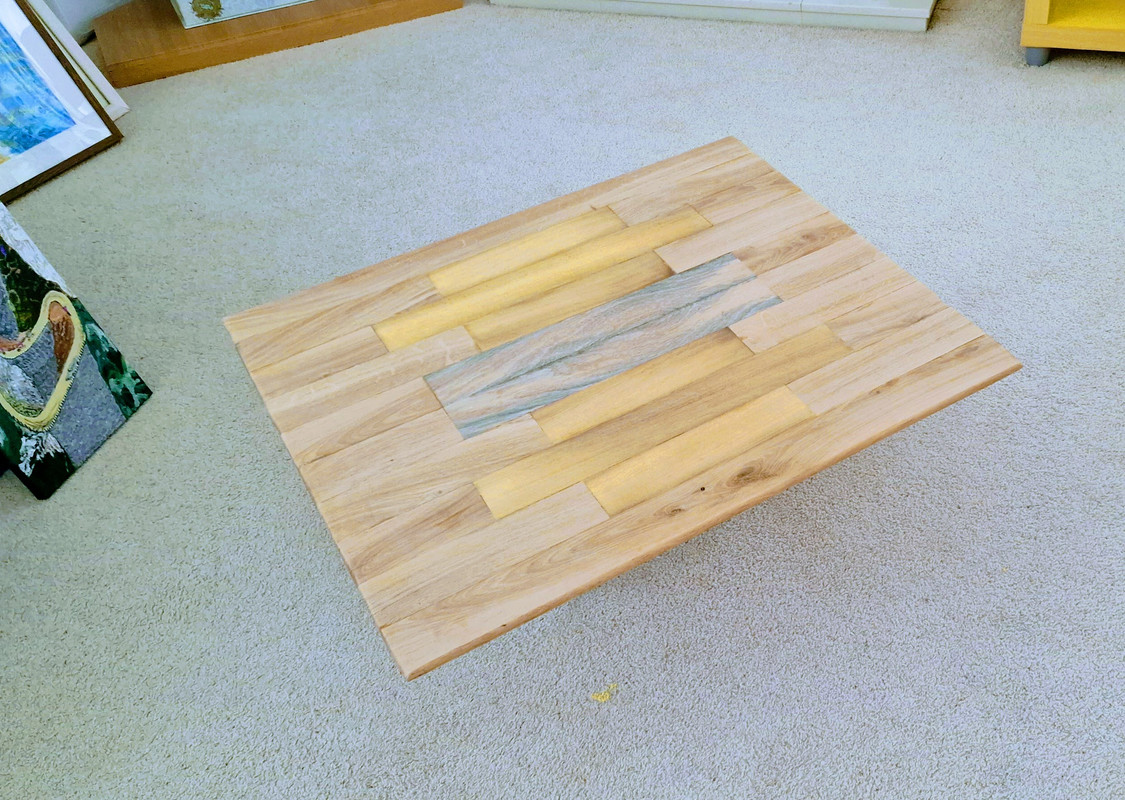

I want some miracle finish that will bring out the colour and grain from the woods while making it child, water and wine proof. I have yacht varnish, Osmo Oil, Danish Oil, clear epoxy resin or can buy something else.
What do I use to protect this raw wood?
Also, I am having serious second thoughts about legs. I am now thinking a large central block pillar in the centre will be easier and stronger that four legs, even if I try to brace the legs. I am thinking of basically building a wooden box with a concrete block for weight and stability and then just screwing the table top onto that from below. Thoughts?

Danish oil for a table top. It’s natural, will penetrate the timber snd bring out the features in the grain. It’s also easy to re-apply and maintain.
Posted : 24/04/2022 5:15 pm
I'd go with Osmo personally. Ime water beads up on it better than Danish.
As with any finish though, it doesn't mean you don't treat anything made with wood with care. Put hot cups on it etc and it will mark.
It looks pretty cool by the way. Nice job 👏
It looks like it's levitating in that second picture. Is it levitating?

[i]Is it levitating?[/i]
Yes it is. I explained that I hadn't decided about legs yet in the original post.
Does the central pillar idea sound feasible?

Osmo Top oil. Used it on some oak worktops. Really brought out the finish of the grain. Try it on and offcut to ensure you like it.

You were right about the Osmo oil bringing out the grain pattern and colours.
Just the first coat, obviously but I am happy. I originally used 180, 240 & 1000 as they were the grits I had and it is silky smooth. I was planning to sand over with 1000 once the oil has soaked in, I assume this won't be a problem as I will be applying a couple more coats anyway.
Final call for wood identification
Outer = Oak
Yellow = ??
Patterned Centre bits = ??

trick with osmo is not to put anything on it for several days - if you don't wait long enough it can still stain
I usually do my two or 3 coats then once dry put a cloth over the table or whatever and leave it on for a week. After that it's pretty much bombproof as the treatment has fully cured

tilly - I will let you know how it goes for me. So far 1 coat brushed on and then rubbed in/off with a microfibre cloth about 5 minutes later. About to sand with 1000 grit and apply a second coat. This is going onto raw untreated wood.
5lab - depends how big the centre pillar is. I suspect it will be more stable that a table with 3 legs and a broken one in the corner

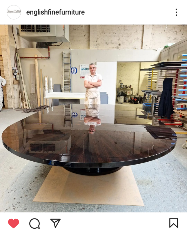

Talking about finishes, a friend/colleague of mine just finished this epic ebony dining table (which I veneered a tiny part of for him 😂) and it was professionally polished for him by a specialist company.
The polishing bill alone would have gotten you a fairly decent ebike...
It's like glass. Not my cup of tea at all but hey... Client likes it.

My table was 180, 240, 1000 because they are the three sanding discs I have for my orbital sander. I brush the Osmo on working it along the grain, across the grain and then at 45 degrees both ways to make sure it is fully covered. I wait about 5 minutes and rub off with a microfibre cloth so it is clean to the touch. I am not sure this is a technique as I have only just done the second coat on the first table I have ever made but it seems to be working. It is currently resting in the sunshine and I was thinking of one more coat later today then leaving it until I have sorted out the base.
Next time I go to the garage I will check which Osmo Oil it is, I think it was originally bought for the kitchen floor.
While I appreciate the skill in that shiny table it looks too much like the plastic wood tables you get in the warehouse furniture stores. This was the main reason I didn't want to use 'liquid glass' acrylic resin on mine which would have given a similar finish.

After treating with Osmo Oil and sanding with 1000 grit the wood was very smooth to the touch and I was happy with the finish.
After treating with Osmo Oil and sanding with 3000 grit the wood was very smooth to the touch and I was happy with the finish.
No discernible difference.
