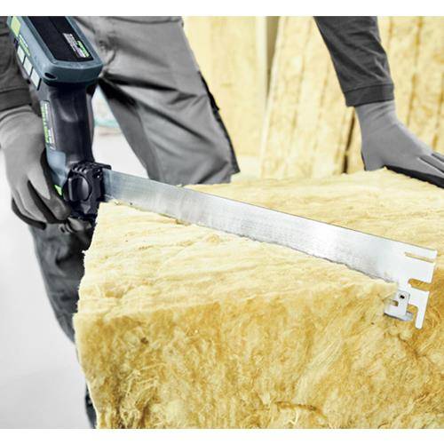

You can cut insulation with an electric carving knife.(great for foam too.
But why spend £9.99 for one from Tesco when you can buy this...
https://www.kelvinpowertools.com/festool-isc240-18v-insulation-saw-set-2x-5ah-bt-1.4m-rail-c-447-p-20774
