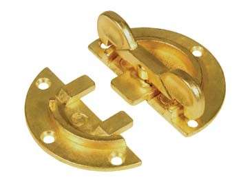

Would something like 2 of these swing catches work? I have something similar on my dining table and it keeps the sections together really well.

Table leaf cleats/connectors

Thanks all.
All look like viable options.
@nickjb - Those Keku fixings look just the part.
