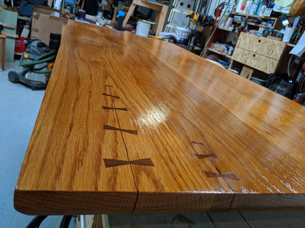

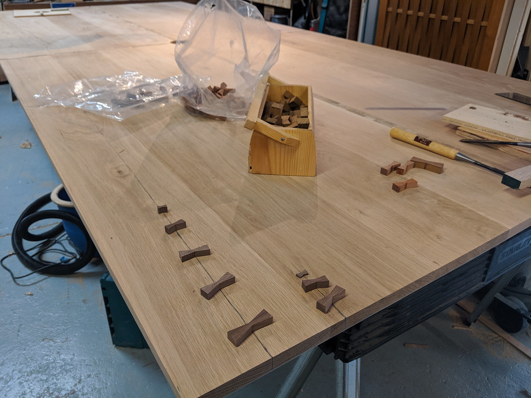

Using butterfly keys to prevent the cracks opening further would be the obvious option if the item was a showy thing like a posh dining table, but in this instance filling with an epoxy/metal powder mix sounds perfect for a work top/ table in heavy, regular use, where all sorts of dodgy stuff can get into the crack. (Ooer, missus). 😁

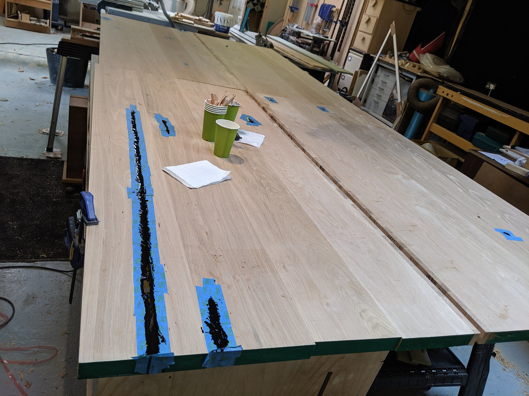

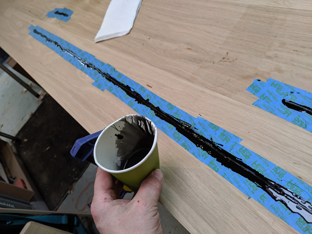

I used a dedicated epoxy kit with a tint from here when I made a mahoosive Oak conference table. It worked very well but as mentioned above, you really need to make sure you seal underneath too as the resin in a thin, pourable consistency will find any way through!
https://www.mbfg.co.uk/polycraft-cleartop-35-bar-table-resin.html
Epoxy pigments
https://www.mbfg.co.uk/epoxy-pigments.html
https://www.instagram.com/p/B01PVYagNBQ/?igshid=lg2idq13c97r

@kayak23 - love that table, nice use of epoxy fill and butterfly keys!
