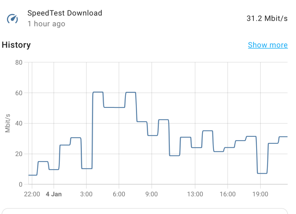

SCR-20240104-stls
We don't quite have LOS to the nearest mast (but it's close by). Using an external Omni antenna this is pretty representative of what we get from our 3 data Sim. Sometimes goes up to 70, sometimes down to 5. It is definitely slower evenings etc. Which you'd assume was congestion although not many people live here! Having said that the DSL is really bad - long way from exchange so maybe 4 meg if it's not raining absolute best case.
