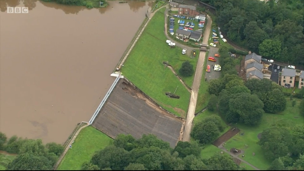

The concrete spillway is not decoration. It is there to quickly transport the overtopping water away from the reservoir. The absence of concrete on that part of the spillway will exacerbate the situation if they get overtopping again as the scouring effect of the fast moving water will wash away more surface layers. If this happens repeatedly the earth wall dam is at risk.
For those stating that people are "refusing to leave", I have family about 500m from it. The roads are closed and have been for hours - nobody goes in or out. Even the road over Disley tops.
Posted : 01/08/2019 9:17 pm
Posts: 2110
Just to add a bit of someone who actually knows what they're talking about (as opposed to ill informed speculation from people who can't be arsed/are incapable of doing a bit of research before spouting off) this from the Grauniad -
Such earth embankment dams are at serious risk of being quickly washed away if the concrete spillways that protect them are damaged, according to Mohammad Heidarzadeh, an assistant professor of civil and environmental engineering at Brunel University London. “In embankment dams, spillways are extremely important, because they prevent embankment dams from overtopping,” he said. “Due to heavy rainfall ine the Whaley Bridge area, the spillway is now broken and a big chunk of its concrete structure is damaged. There is a possibility that the spillway could then become fully broken in a few hours. If the spillway is fully gone, the embankment dam will be washed away very rapidly, which could cause a massive flood.”
So in layman's terms, if the concrete skin goes, the risk is that the water scoops away the earth underneath, thereby compromising the structural integrity of the earth wall. This may already have happened, maybe not. I certainly wouldn't be chancing it. Fingers crossed for all affected

Clearly show some sizeable plants growing on the spillway which given their size must have roots which pass completely through the concrete skin of the spillway.
The fact the plants arent being washed away in the video despite the volume of water passing by suggests the roots are sizeable.
Failure of the joints between the seperate concrete slabs allowing the clay earth underneath to be washed away eventually leading to the slabs failling themselves.
Maintenance failure will be pretty hard to talk their way out of.

Not having read all the above I'll jump in here as a civil engineer.
Earthfill dams always have a water cut off built in - watertight upstream face, internal clay waterstop etc. Earth on its own won't hold back water, water will move through the pores saturating the whole structure until it fails by a mechanism such as a rotational slump or piping. Think of building dams of sand as a child on the beach - they'd always ultimately fail as the sand became saturated.
In dams of this era the waterstop is nearly always clay. The initial failure has been the concrete of the spillway, but it is particularly interesting to read that a clay layer beneath the spillway has been eroded. I'd be surprised if this clay layer was the main waterstop for the structure, common sense says the less of the structure with saturated pore spaces generally the more stable the earth fill shall be. The clay layer here may have been designed to stop water running down the spillway from saturating the downstream face of the embankment - the joints in the concrete slabbed spillway may not have been waterproof as designed.
In summary if the waterstop is gone piping failure is a very real risk. I think in any case the earth fill embankment is now saturated in this area so that sudden collapse through a slip or slump is a very real risk. This would be a very sudden event.
The water level will need to drop substantially for this risk to reduce.

Just found this in New Civil Engineer magazine. Sounds like it is primarily boulder clay construction after all.
Posted : 01/08/2019 11:10 pm
Posts: 4313
The New Civil Engineer piece is good. There's also a good collection of videos and comment in this link. The blogger is a pilot who has provided some of the best coverage of the 737 Max fiasco - he's pretty level headed.

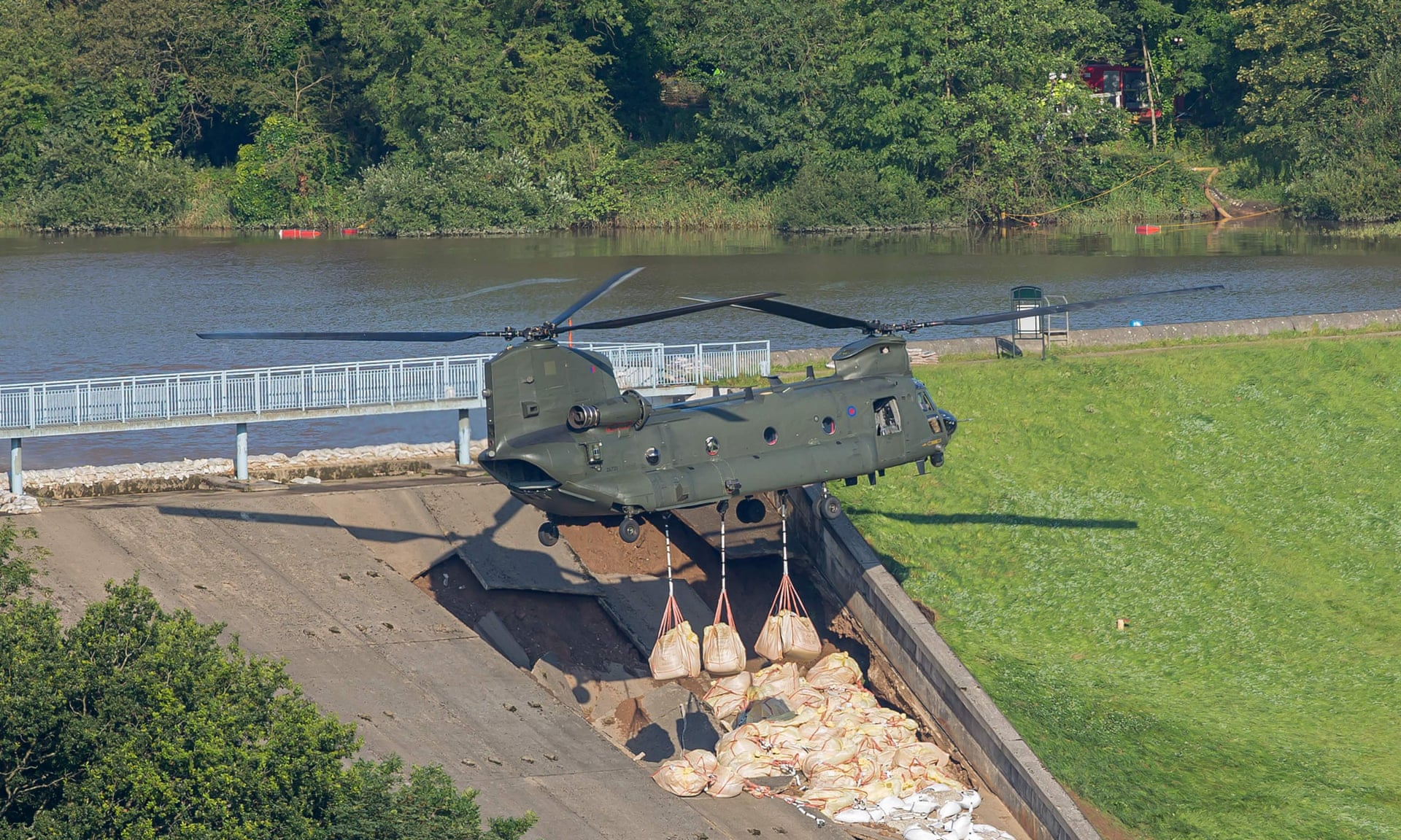

They had a Chinook up there last night bringing in ballast.
Posted : 02/08/2019 7:51 am
They are currently dropping bags of aggregate into the 'hole' via a Chinook - it's a ruddy big hole looking at some of the pictures on line with the bags already in there.
Posted : 02/08/2019 7:58 am

[url= https://i.postimg.cc/PPMcDcyg/Screenshot-20190802-081245-Facebook.jp g" target="_blank">https://i.postimg.cc/PPMcDcyg/Screenshot-20190802-081245-Facebook.jp g"/> [/img][/url]
Just screen grabbed this from Facebook. What a pilot!
Posted : 02/08/2019 8:14 am

We were also assisted overnight by RAF crews who used a Chinook helicopter to move more than 50 tonnes of aggregate into the reservoir wall to reinforce it.
This work was done in conjunction with expert structural engineers, who have been advising the emergency response since yesterday afternoon.
Throughout the day, work will continue to further shore up the reservoir wall. The Chinook will also be dropping aggregate into other parts of the reservoir today, to stem the flow of water going into it.

Some amazing shots of the Chinook in the press.
Posted : 02/08/2019 10:29 am
Posts: 1055
The scary thing for me was not the water over the top of the spillway, but there was a video showing water coming out of the area that has collapsed.
which says to me the breach was round the outside of the concrete structure or through the main dam bank.
Posted : 02/08/2019 10:36 am
Posted 2 hours ago
I'm pleased to see they found some bigger sand bags.
Posted : 02/08/2019 10:48 am
 nbt
Posts: 12381
Chinooks in action on Long Hill
Posted : 02/08/2019 10:49 am
 kcal
Posts: 5448
Indeed, just seen an image from slightly above and to the side - of the Chinook dropping aggregate bags.
Penalty for failure: high!
see if link works -
Chinook at Toddbrook reservoir.
Posted : 02/08/2019 11:26 am
I love Chinooks. What an incredible bit of kit.
Also, note to self - do not attempt to ride over Long Hill today.
Posted : 02/08/2019 11:31 am
Posts: 1489
Those vids of the chinook are amazing - that is some control of a beast like that! Very impressive
Posted : 02/08/2019 11:35 am

Second picture down, beneath the "How Dangerous is it?" subtitle - https://www.bbc.co.uk/news/uk-england-derbyshire-49201467 shows earth to the outside of the spillway wall to have been washed away as well. Possibly due to spillway water eventually undercutting the wall - no way of telling for sure.
Posted : 02/08/2019 6:04 pm
One of the videos yesterday which I can't find now shows water at the top of the spillway jumping over the sidewall onto the earth embankment probably scouring the embankment from the top, not under the sidewall.
Posted : 02/08/2019 6:42 pm
