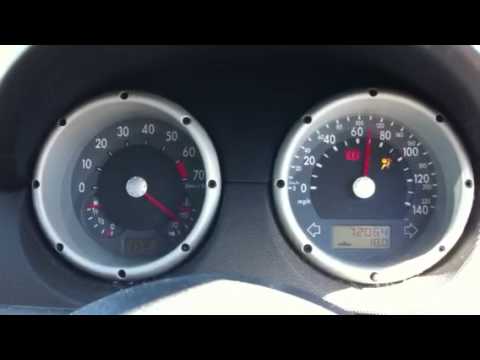

Not sure alanf, it does stay on after you've removed the key so maybe. Can't remember offhand if it's still on when I get in the car.
Same as this.
