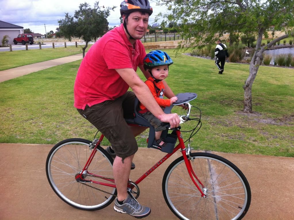

I have one and despite what this picture may suggest the wee man loves it. I tried it on a Cotic Soul at first, it fit the bike ok but made it very difficult to ride. The seat got in the way of my knees, and reaching over the top was hard.
Fitting it to this big old steel roadie was much better, nice and high out of the way of my knees and swept back bars for more upright position for dad. I know people fit them to mountain bikes, but I'm really not sure how....

Ishouldbeworking - is that suburban Perth in the background to your photo?

Perthmtb - Yup, that picture of mine is in Thornlie, Perth
