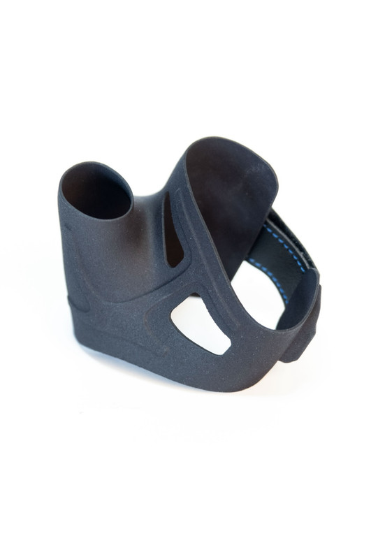

I have been diagnosed with serious arthritis in my thumb joints, which has lead to carpal tunnel syndrome and pain up my right arm, so far my left is just the thumb joint. Taking Naproxen morning and night helps, I was taking it in the morning for my knee anyway, and also a wrist brace as mentioned above, with a support strip in it, which has been a great help.
I find the brace a bit cumbersome to wear during the day, so I’m working with a company who specialises in orthopaedics and orthotics to create a lightweight 3D printed brace that I can wear when using my bow, which would also probably work on a bike.
It’s very expensive, and it’s taking time to make, because they’ve never made anything like this before, so we’re making prototypes and I’m a bit of a guineapig in the process. The specialist I’m working with has been to a conference last week with my prototype brace, to pick a few brains.
This is all fairly cutting edge stuff, and I’m keeping my fingers crossed that it’ll be as effective as I hope!
This is the first design they created, the actual printed one is longer and goes over my wrist and further up my arm:
